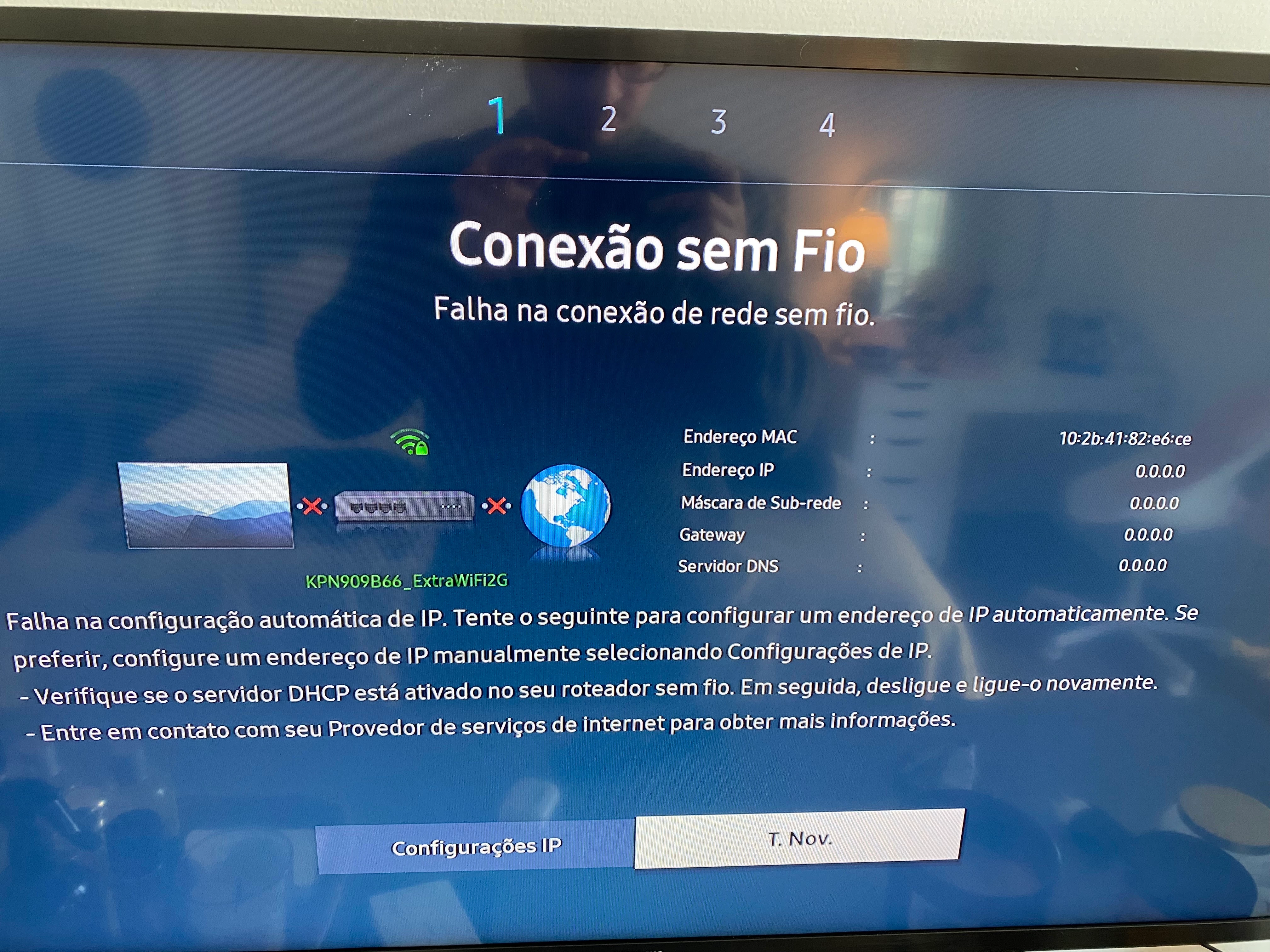

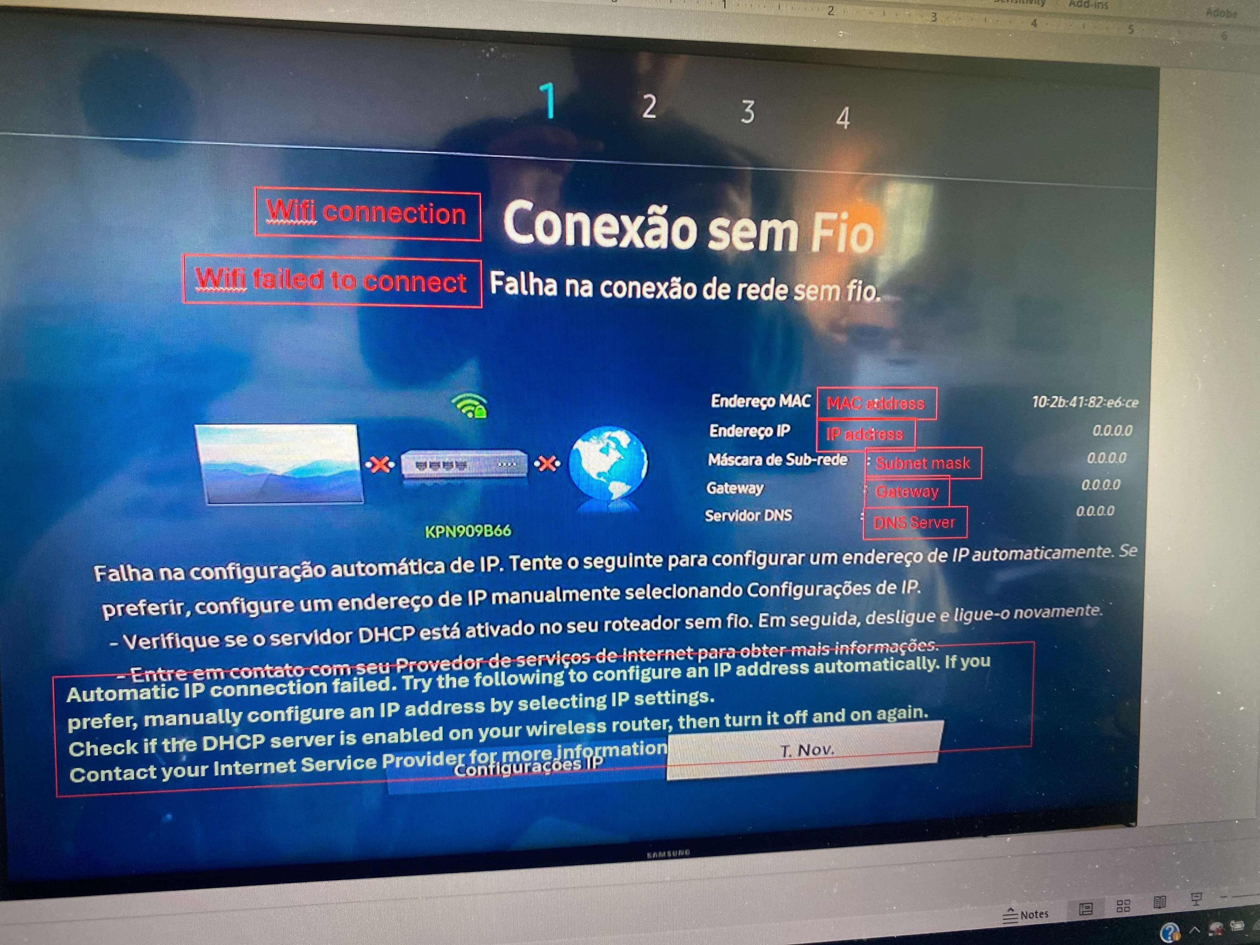

WiFi  failed connection error on KPN909B66 KPN Box 12b (the standard WiFi network to which all my other devices are successfully connected): **My apologies for the Portuguese language on the TV screen, but a translation is indicated in red color for each field.**
WiFi failed connection error on KPN909B66_ExtraWiFi2G KPN Box 12b (alternative WiFi network_2G attempt).
