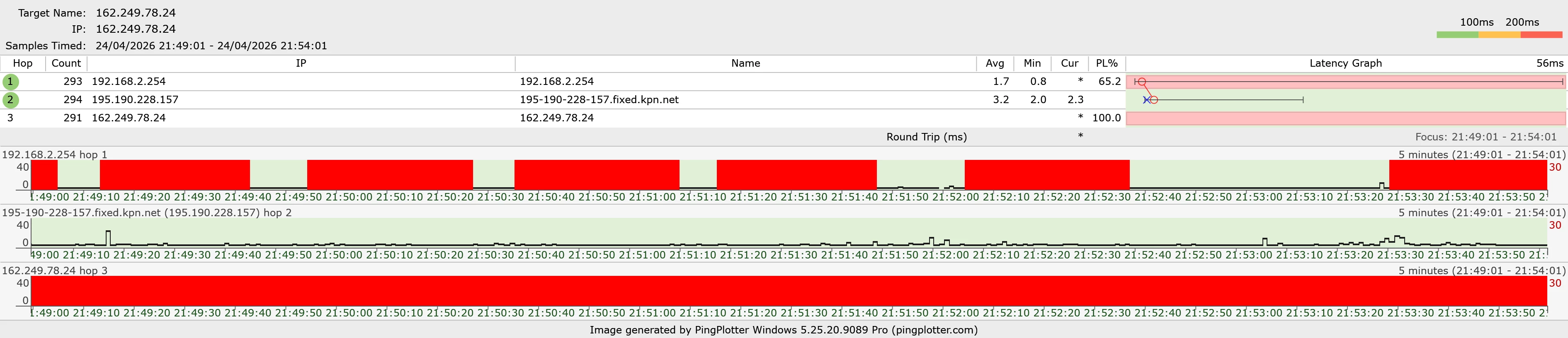

Ik ervaarde problemen met een spel (league of legends) ik heb verschillende troubleshooting gedaan welke ook vermeld zijn op mijn reddit comment: reddit troubleshooting stappen op subreddit van league of legends Ik kan niet verbinden met de client tijdens het opstarten van de League of legends client.
ik heb een ping pong gedaan richting de ip addressen van League of legends Ik heb een bekabelde internet verbinding.
De support van League of Legends geeft het volgende aan:
Alright, that looks related to some issues that your Internet Provider is currently facing in regards to their routing to our servers. Even if other games or apps are working okay, keep in mind that each of them have different routes, so the issue might only affect your route towards our game. Additionally, since multiple ISPs might use a similar routing, this could affect several players at the same time.
Since there's not much that we can do on our end of things, try to contact your ISP and ask them to look into it.
If you need help about how to approach them about the situation, you can ask for a re-route, and it is a good idea to request your ISP to assign you a static IP address if possible, and you would need to ask them to verify if you are getting a consistent public IP with all your traffic bound to the Internet, regardless of protocols.
Also, you can try asking for a Tier 2 or a Specialised agent, since they should be able to find the root of the problem more easily.
In case your ISP needs all the details regarding the route that we're using, provide them our PeeringDB [https://www.peeringdb.com/net/5918] page and suggest them to contact us directly.
ping pong naar server van league of legends

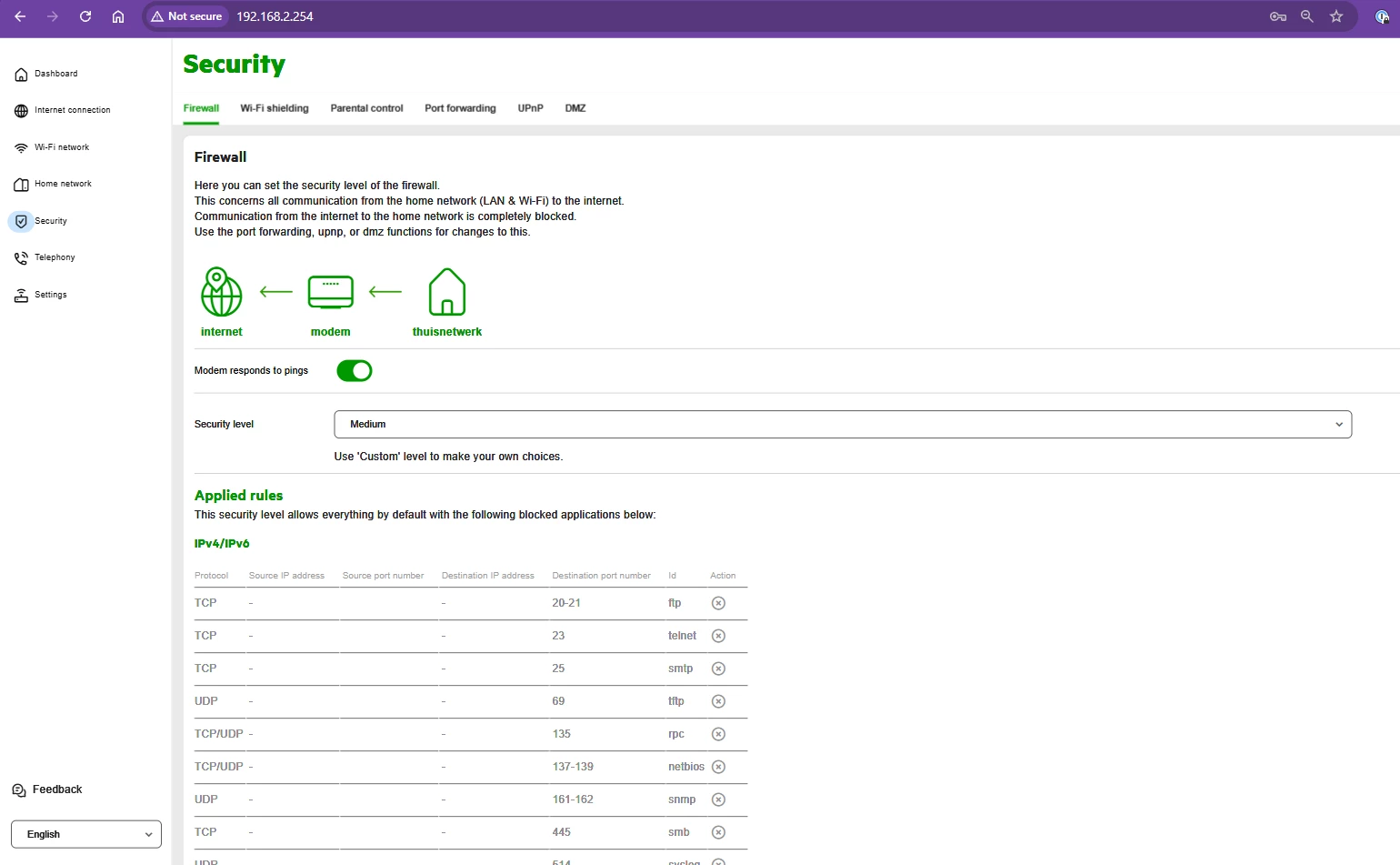

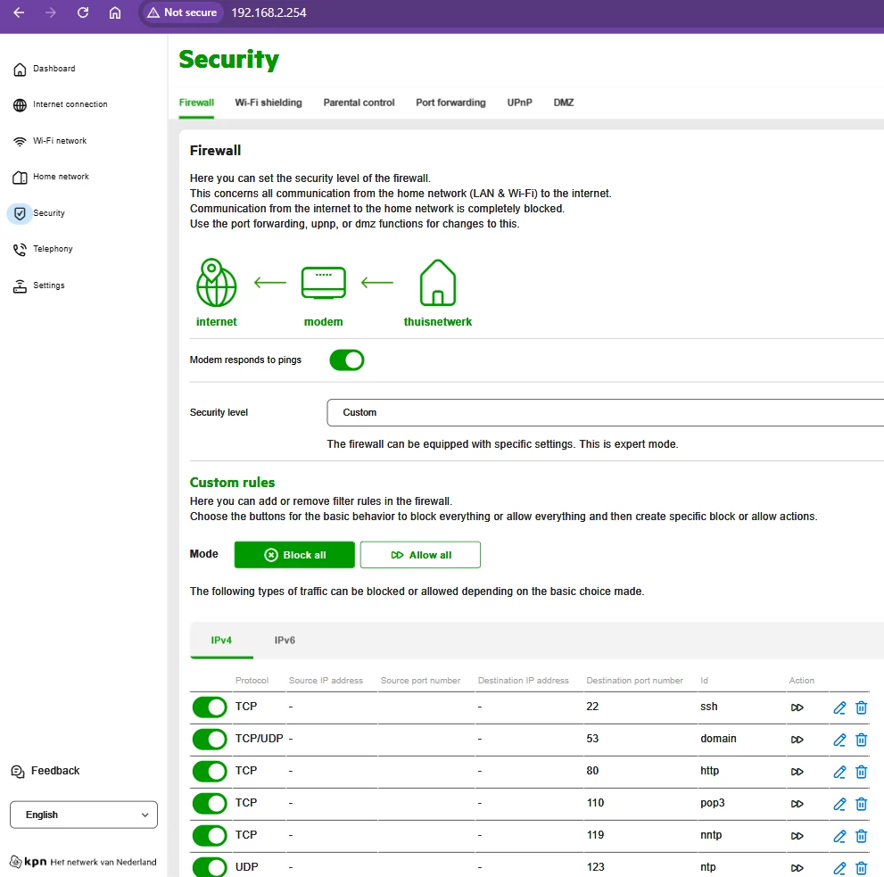

Ik heb het gevonden… Blijkbaar was de issue mijn eigen modem. Deze had een custom security level wat nodig is bij mijn kpn box (SagemcomFast5359_KPN) om een port forward te doen. Echter is het rare dat dit 2 dagen eerder is gedaan en pas de volgende dag had ik problemen. Als je de custom security level aan hebt staan dan onder je firewall dan staat de mode automatisch op block all. Gelukkig weet ik dit nu en hopelijk de rest ook.
Let erop dat als je port-forward op een kpn box en je een specifieke port wilt toelaten of blokkeren in jouw kpn modem firewall dat de mode automatisch op block all staat.
Terug gaan naar de medium security level zorgt er voor dat alles weer werkt.

Hoe kom je erbij dat die game servers reageren op ICMP/ping? In 99,9% van de gevallen reageren game servers hier helemaal niet op en accepteren ze alleen connecties met game info.
Ook kun je niets concluderen vaak een trace route omdat alle tussen hops ook vaak niet hoeven te reageren op ICMP/ping. Een traceroute of pingplotter helpt je hier in ieder geval niet verder mee.
Zie punt #2 van deze pagina.
https://www.cloudflare.com/learning/network-layer/what-is-mtr/
Ps. Als je echt 100% packetloss zou hebben naar die server dan zou je ook helemaal niet kunnen connecten (wat je dus wel kan).
Je geeft verder niet aan wat je probleem precies is (alleen de verkeerde conclusie dat het aan die 100% PL ligt). Maar het kan zijn dat als de routes naar die servers niet optimaal zijn, dat je lag en hoge ping kunt hebben. Dat zou dan iets voor de peering office zijn.

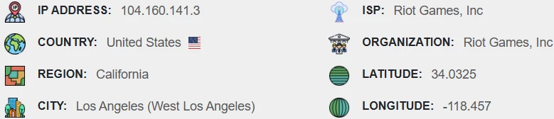

Wil je zeggen dat die Riot Games nodes ook de game servers zelf zijn?? Ik had het n.l. over de game servers zelf. En die reageren bij Riot Games niet op ICMP (wegens de eerder genoemde reden). Tenminste, bij mij niet. Als die bij jou wel reageren op ping dan horen we dat graag.
NA - 104.160.131.3
EUW - 104.160.141.3
EUNE - 104.160.142.3
OCE - 104.160.156.1
LAN - 104.160.136.3
  • apr 25, 2026 8:34 a.m. UTC
Als je ook KPN heb, bevestigt het vermoeden dat KPN deze servers blokkeert of niet juist routet. Van Odido of VPN is geen probleem deze game te spelen.
NA - 104.160.131.3
EUW - 104.160.141.3
OCE - 104.160.156.1
LAN - 104.160.136.3
Staat in de screenshot van gameserverping. Bovendien zijn jouw servers ip adressen niet meer actueel (dat zijn van jaar 2010). 104.160.141.3 behoort tot een ip adres in America, dus kan nooit in Amsterdam zijn.

Weet jij het IP van de EUW? En kun jij de game server uit de openings post wel bereiken met ping?
Ik had even gedacht dat 104.160.141.3 een anycast IP was maar dat lijkt ie niet te zijn (in ieder geval niet volgens ipinfo).
  • apr 25, 2026 10:27 a.m. UTC
Dit is wat de support van League of Legends heeft aangegeven:
Samen met deze 2 ip adressen:
162.249.76.23
162.249.78.24
Fijn dat je het opgelost hebt 😀
De Firewall instelling die je daar laat zien is alleen voor UITGAANDE poorten. Die hebben dus niets te maken met de port forwards voor binnenkomend verkeer. Maar als dat inderdaad een poort staat die gebruikt wordt, dan heb je dus geen verkeer naar buiten.
Ik heb de Firewall daar ook gewoon op Standaard gezet zodat er niets van binnen naar buiten geblokt wordt (ik vertrouw erop dat mijn interne apparaten in orde zijn).
Maar dus voor de duidelijkheid (en dat wordt ook in die tekst daarboven uitgelegd) de Firewall tab is voor verkeer van binnen naar buiten en de Port forward tab is voor verkeer van buiten naar binnen.
