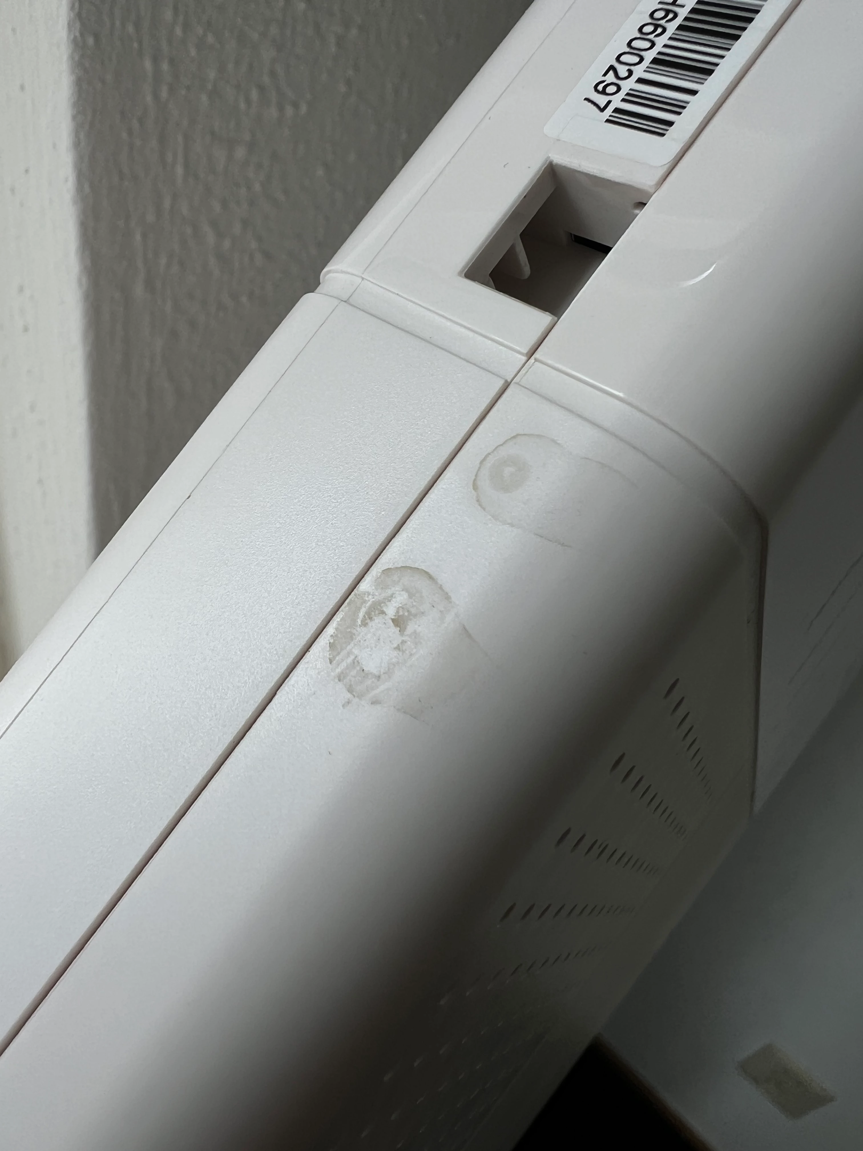

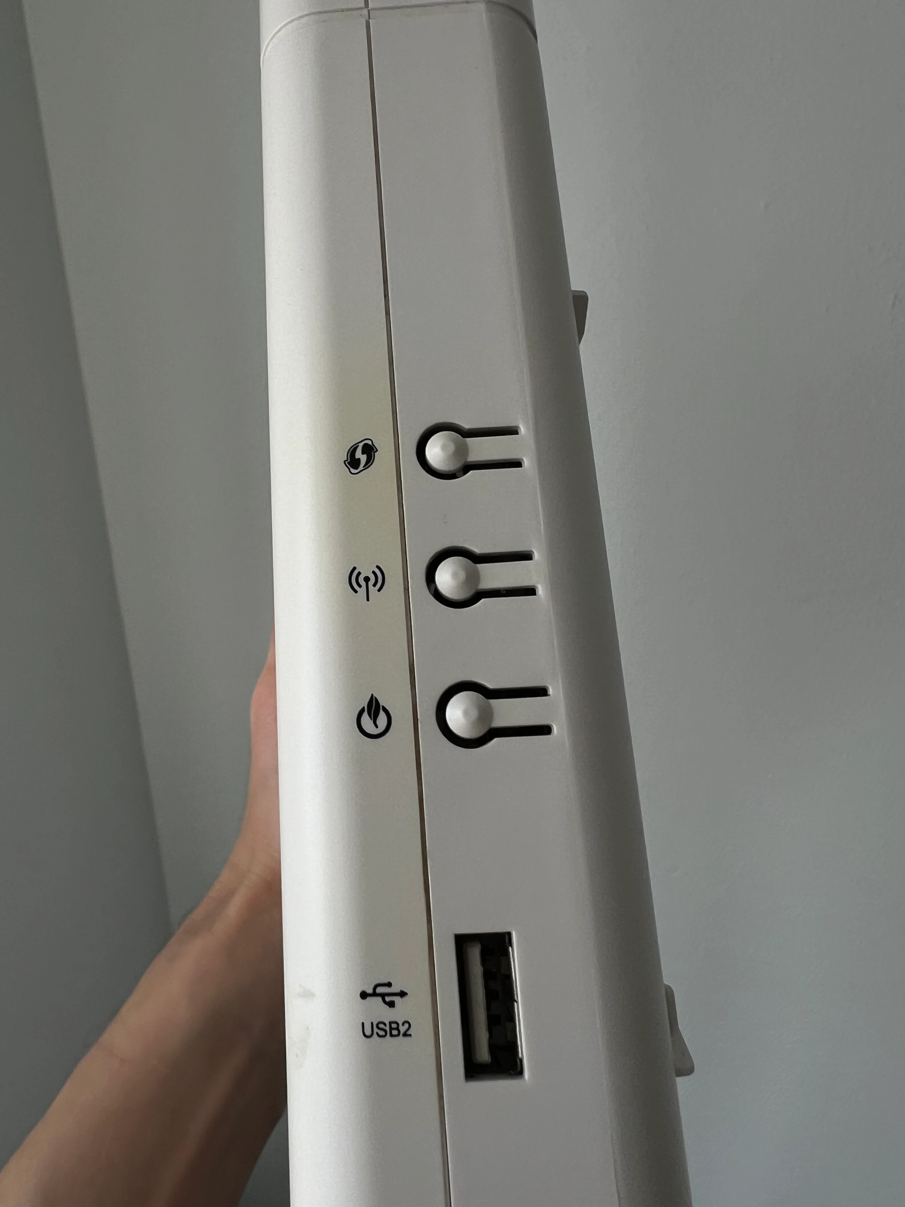

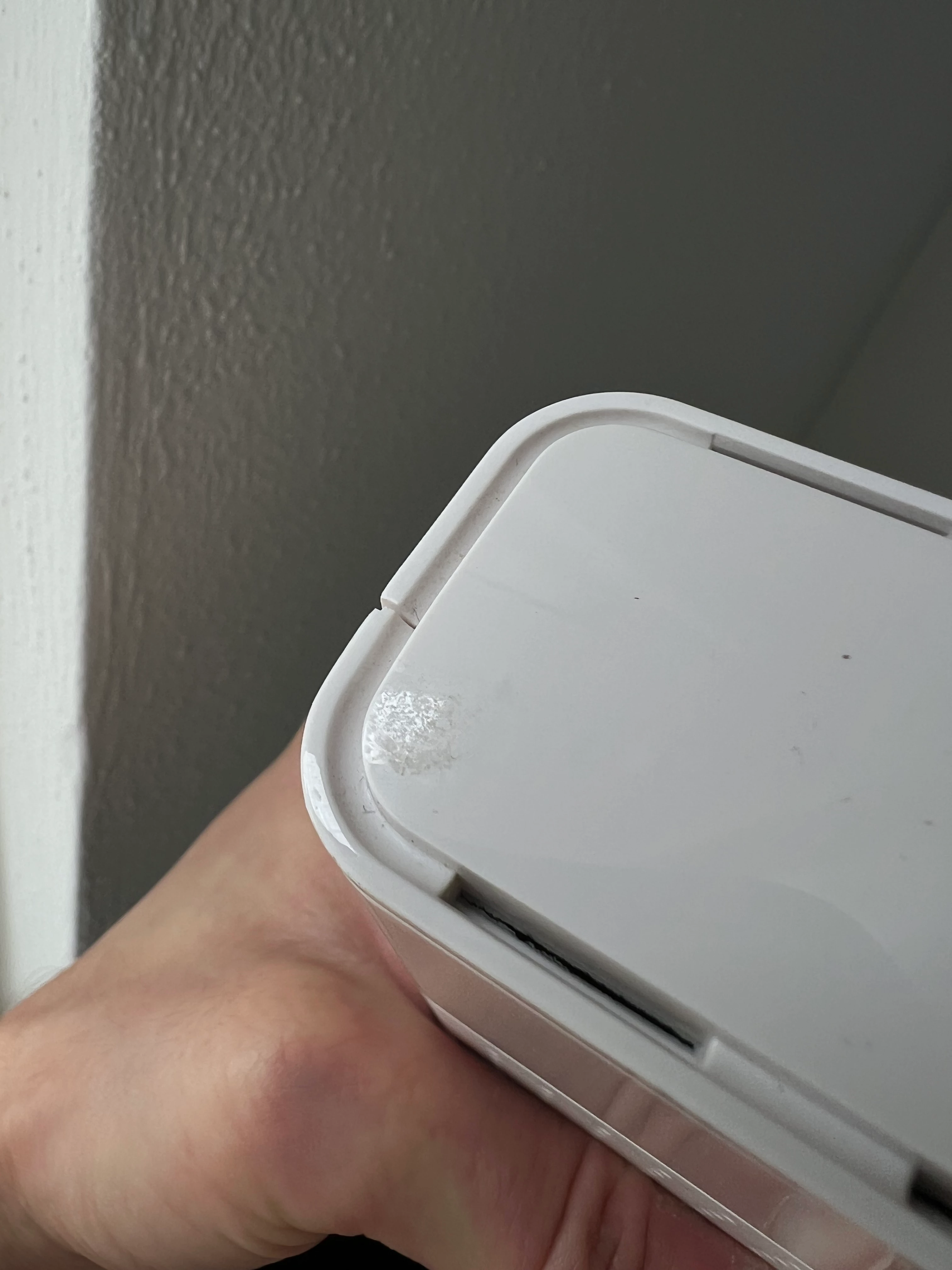

Hi,
At my previous address I had a new modern router KPN Box 12 with Wifi 6.
After moving to a new place, I received an old (both in terms of specifications, and literally with dirty and yellowed plastic) Experia V10.
Why? Is this a thank you for being a customer? What’s the logic here?
I need Wifi 6 for my use case. How do I arrange that?
Only interested in KPN staff support.

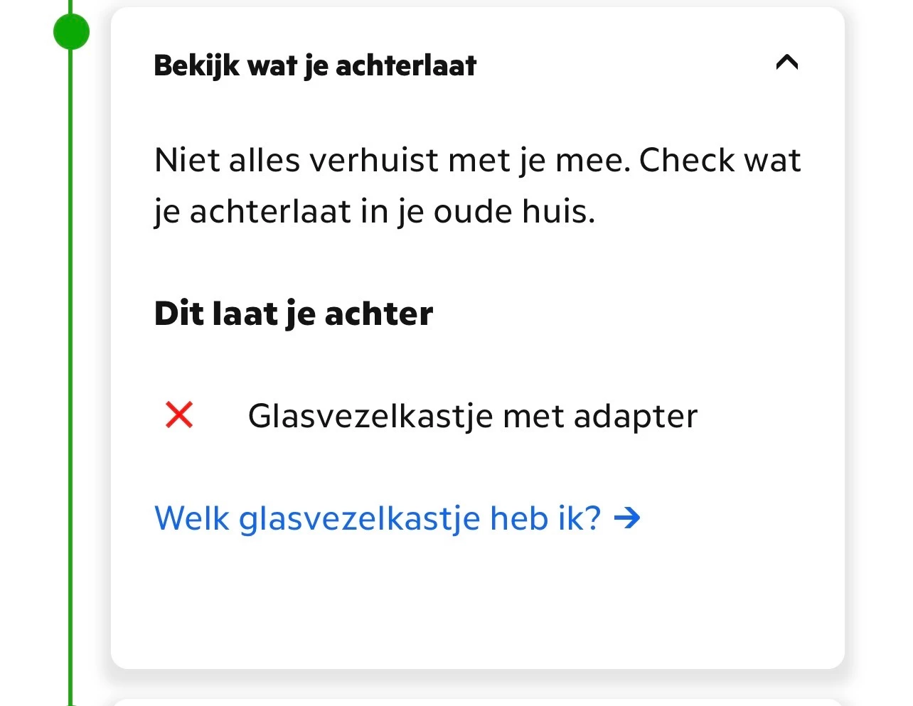

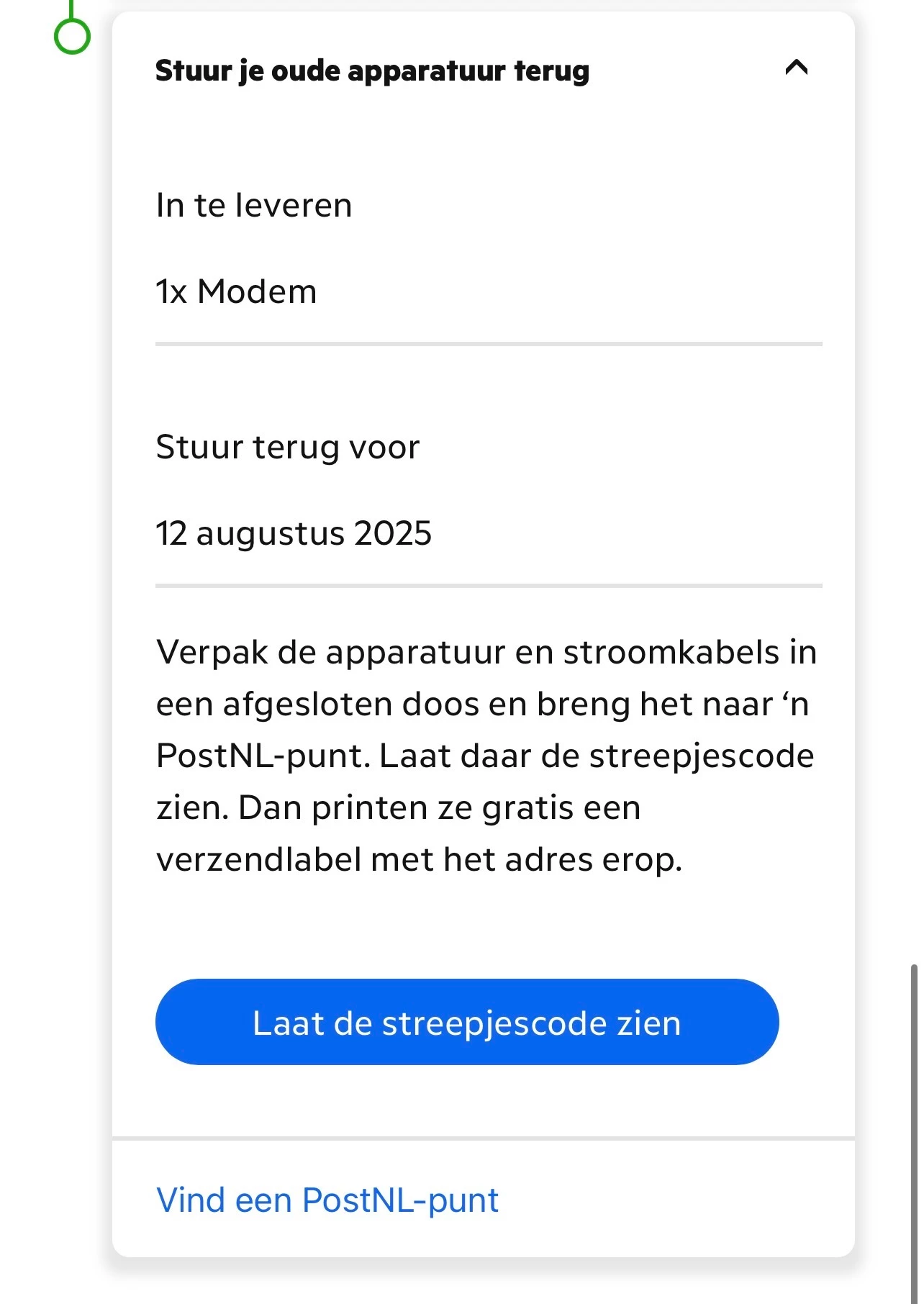

Hi ​@Remco van KPN , and ​@TDN, thank you so much for your replies. This is what it says in the app:
Leave fiber optic box with adapter (which I did)
And it says to return “1x Modem” (doesn’t specify, but it is KPN Box 12 in my case):
Return your old modem before August 12
Do you think I should call KPN and ask if I can use the KPN Box 12 from my old apartment instead, and return the Experia Box? Is that possible?

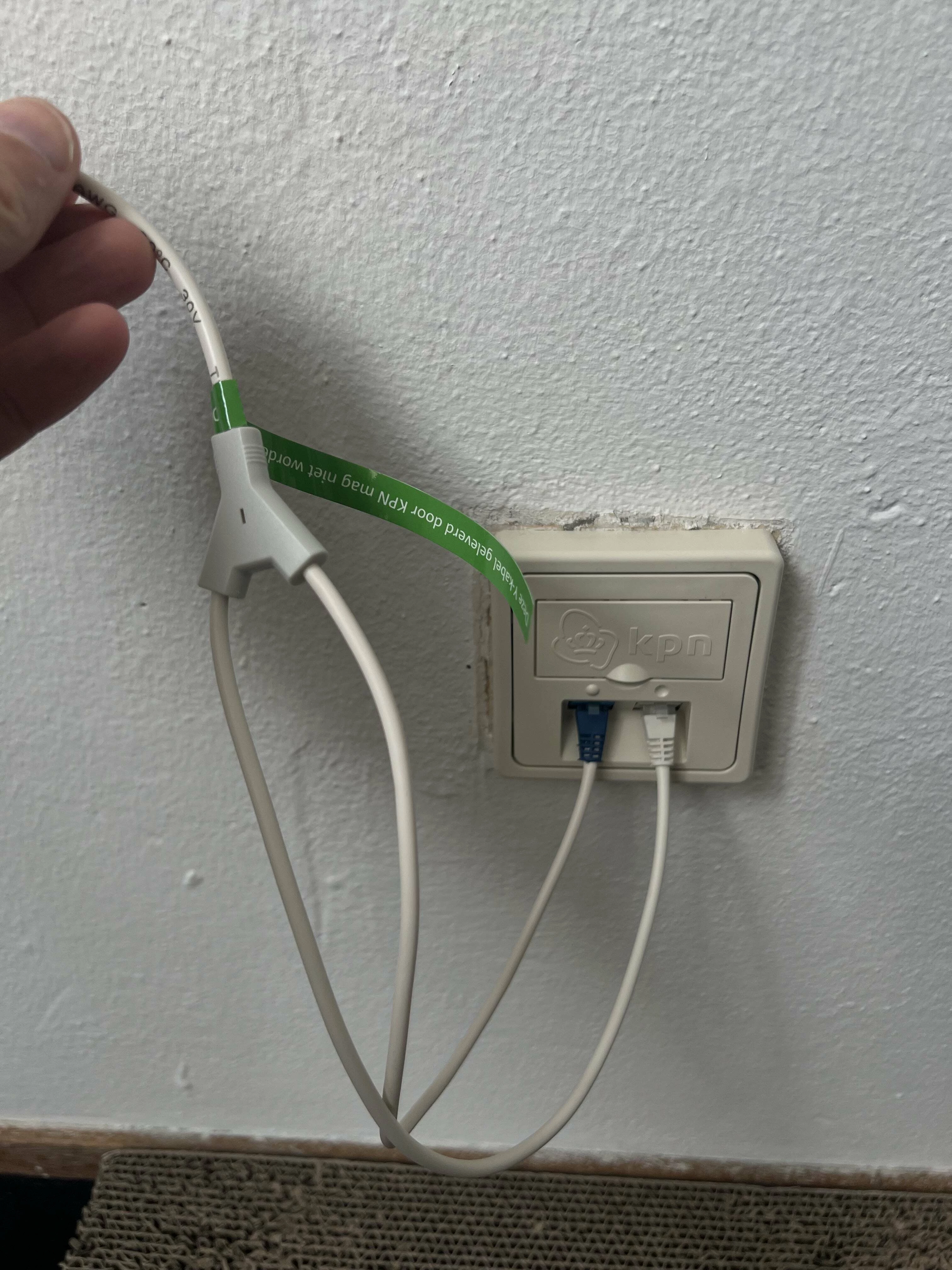

it could be possible that the connection you recieved at your new home, is only possible with de V10 instead of the Box12.
we call this Pair Bonding. its a DSL connection that uses 4 wires instead of the usual 2 wires. this type of connection is only possible with the V10.

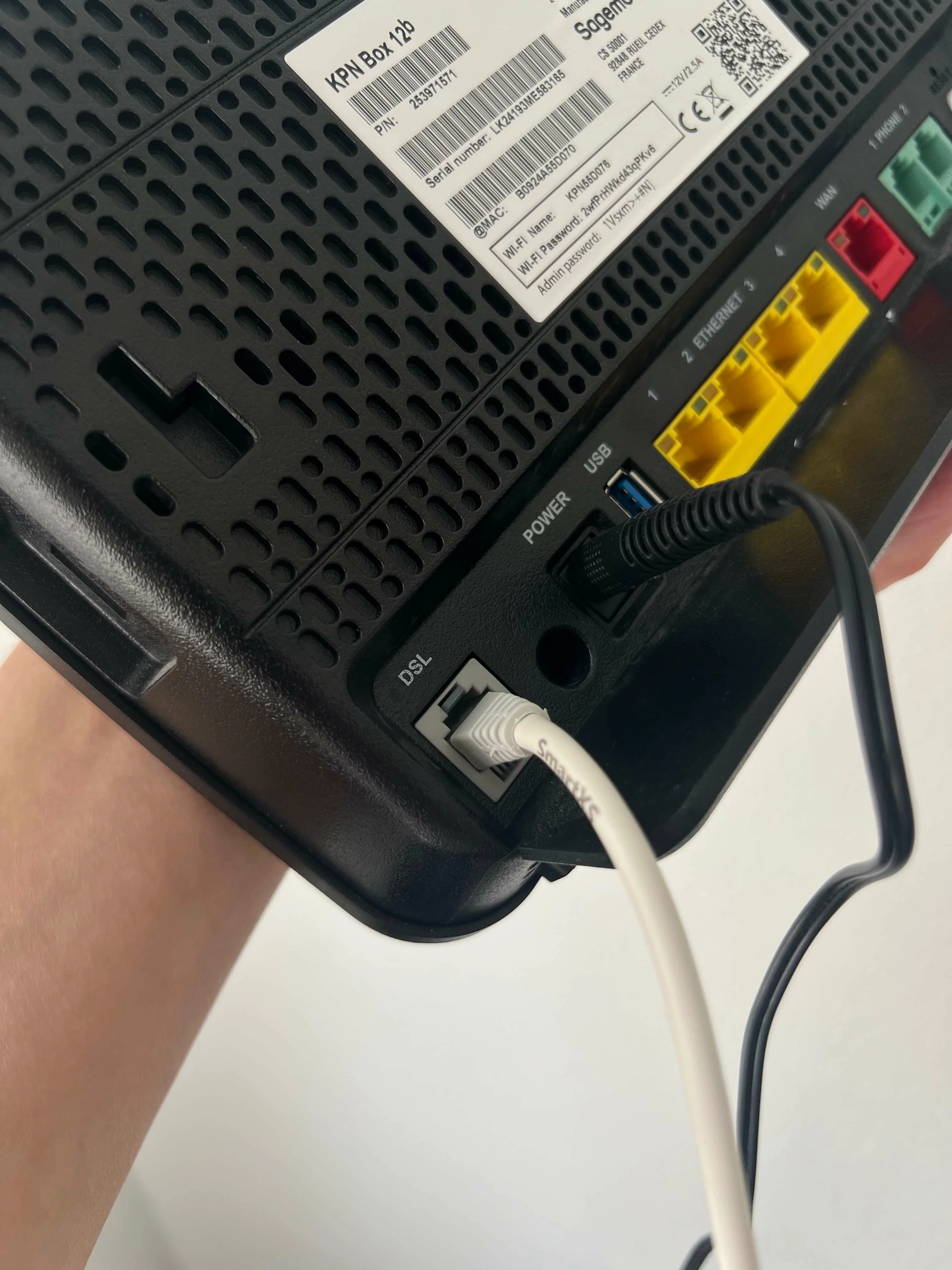

Hi ​@joey92, thank you for the reply. Honestly I’m not too sure about the wires, the monteur took care of all this today. I connected the KPN Box 12 just to test, and it works (in router settings it says connection type is VDSL). This is what it looks like now:
  • July 29, 2025
Dit werkt wel. Maar nu heb je maar de halve snelheid.
Alleen met de Experiabox v10 kan je de volledigheid van de verbinding benutten.
Doe een speedtest bij beide modems, dan kom je er vanzelf achter.

you are gonna need the V10 in this case. this is the type of connection i just talked about. you only get the full internet speed with the V10. with Box12 you only recieve half the internet speed.
