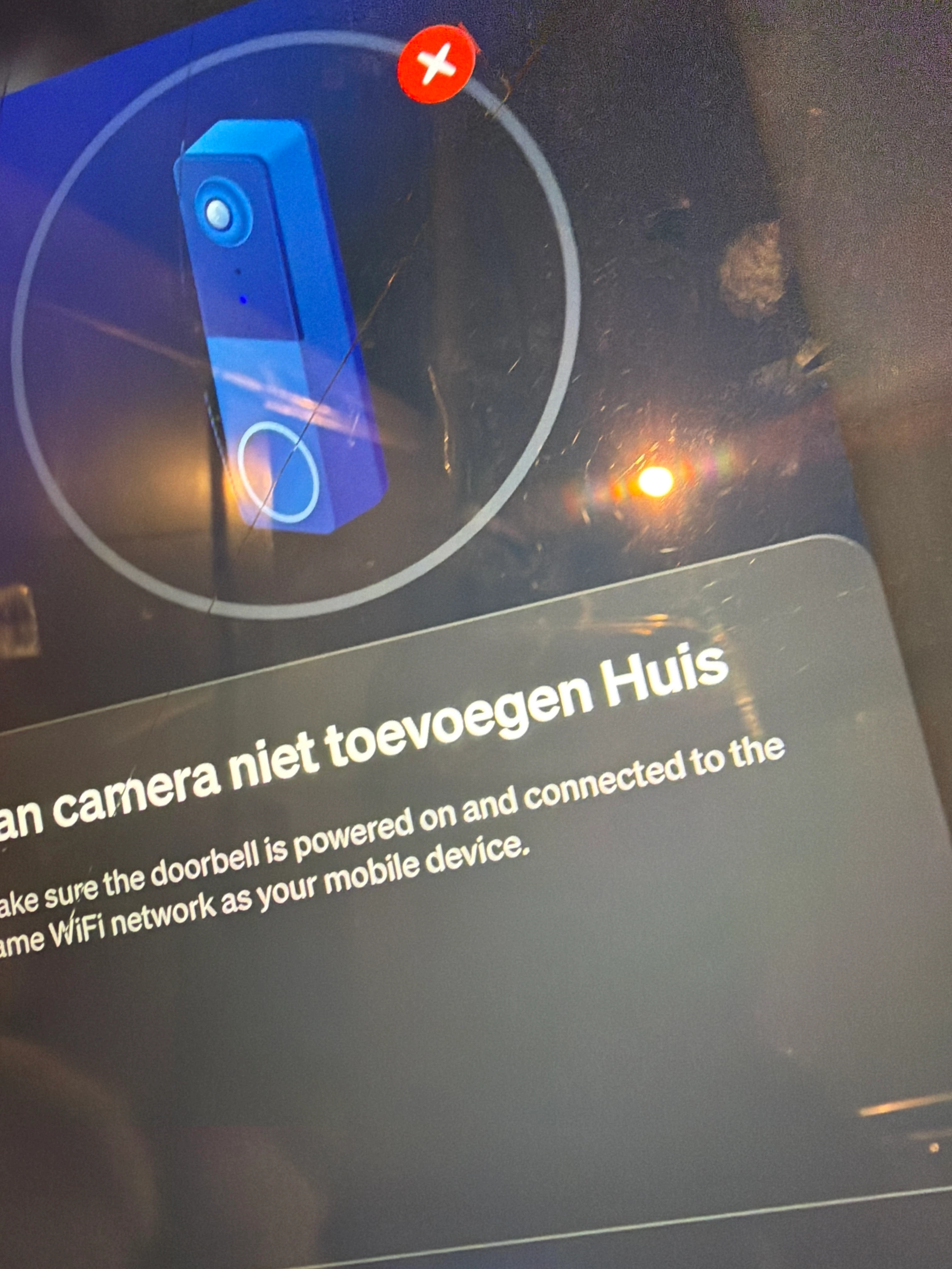

  • jan. 30, 2026 4:41 p.m. UTC
Foutmelding: Kan camera niet toevoegen; make sure your doorbell is powered on and connected to the same wifi network as your mobile device.
Experiabox V10 + 4 wifi extra punten van KPN
