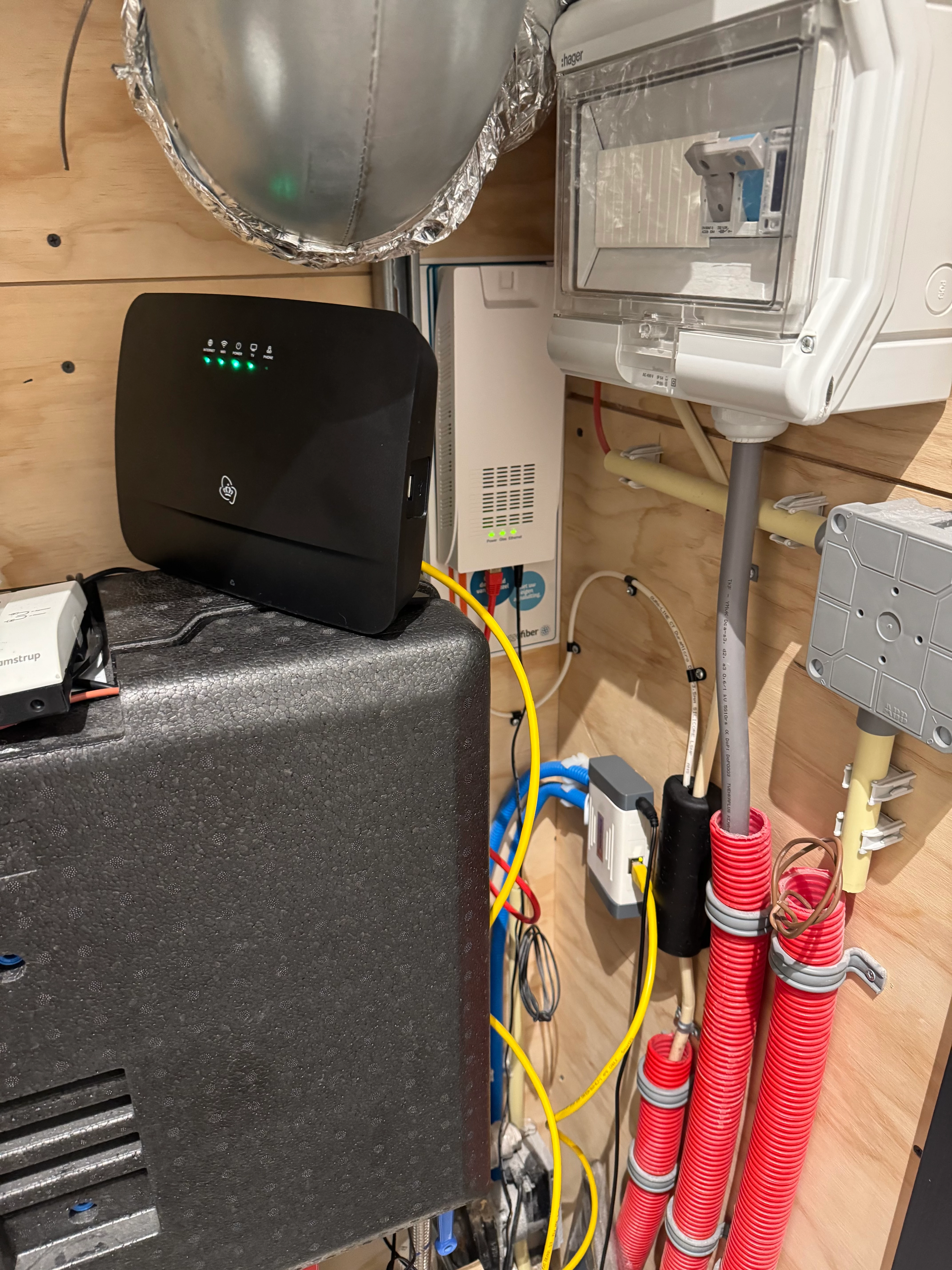

I have KPN BOX 12 and now I had to place it inside the meter cast. The issue with this is now I have low Wifi signals in my living room. Let me explain my apartment setup.

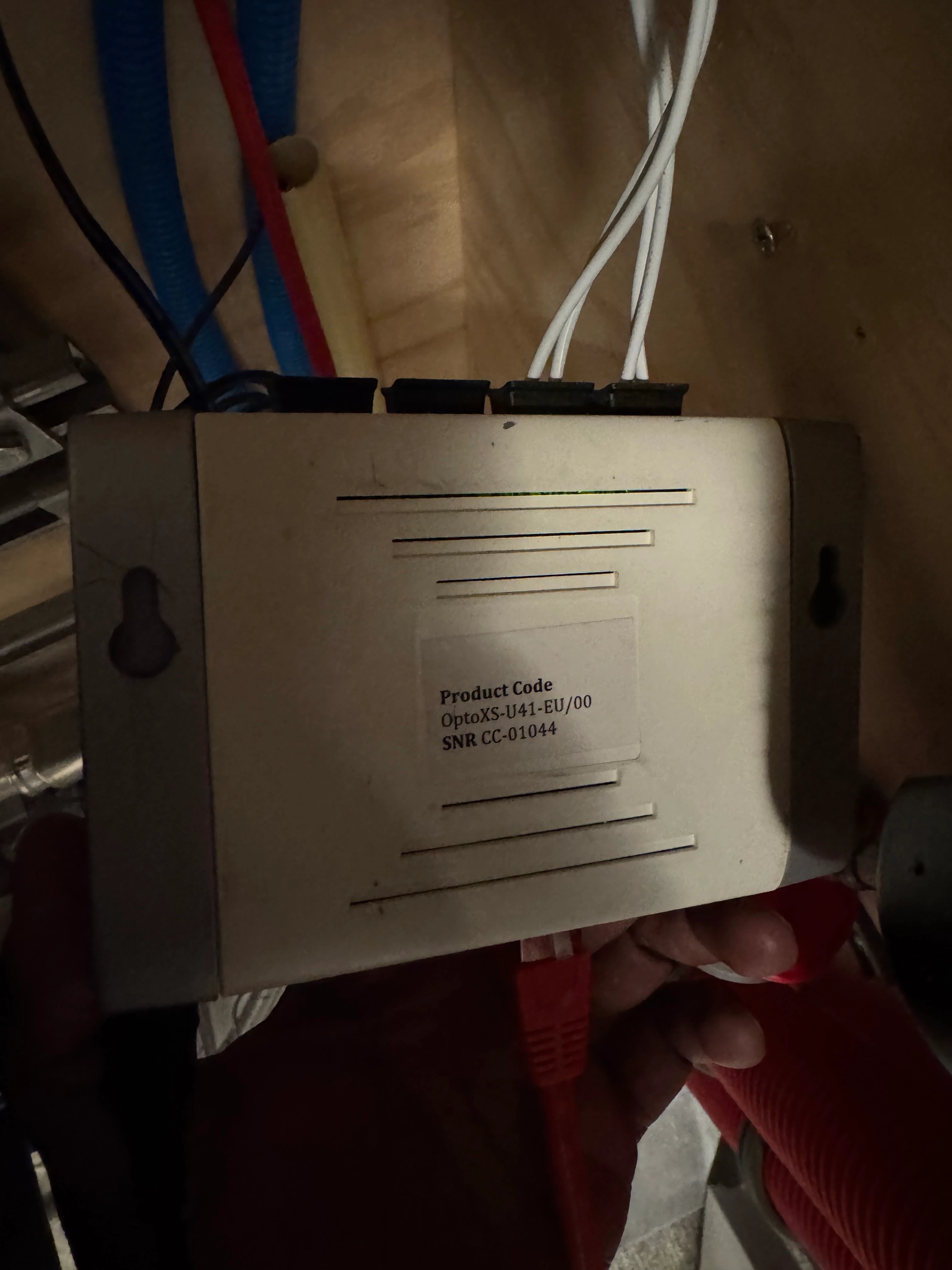

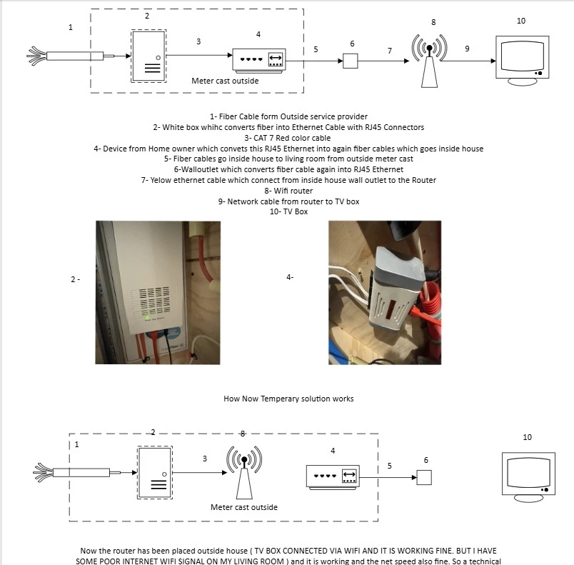

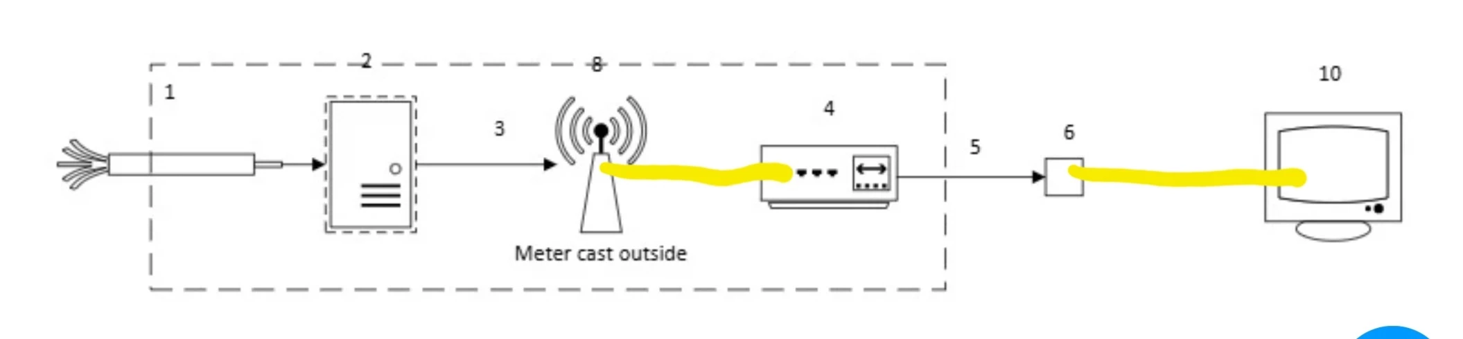

First there is a fiber comes from outside to my meter cast and there is converter which converts fiber into ethernet. If i plug my red cable to that converter and other end to the router my router shows wifi speed 200 mbs. But i want to take this router to my living room and there is another equipment/converter inside meter cast which convert ethernet into fiber optics and then send it to the living room wall outlet and output as again ethernet. My previous router with odido works fine with this and i can not use this KPN routers inside home. Because it gets no speed internet at home.
KPN technician came and said problem is with house installation. Technician from apartment came and replaced all POF and still the error exists. also he said all KPN routers has this issue.
My question is what kind of Input ( RED RJ45 PORT) expect to works fine ? I mean i need tech specs of ethernet input that this KPN BOX 12 is looking for to work healthy?
Also can this be the reason my setup converts too much i mean first fiber into ethernet , then again ethernet into fiber and at last in wall outlet in living room converts fiber into ethernet ?

my cast now.
 the device from home owner which converts ethernet again into fiber and sends inside house. one connection to living room and other wall outlet to bed room.

Hi, Thank you for your email. My issue is I need to take the WIFI router inside the house. Regarding that I want solution. because once i connect red cable to Optoxs and then place router inside the house the internet is not working.

If I keep the router inside the cast I will lose the wifi at some points in my living room. This is why i want to know the exact technical info what is KPN Box12 expects to be get as input. I need signal specifications / limits /bandwisths to know. then I can chaeck the Optobox specs will match this or not.  As you said now no one helps me. KPN say apartment needs to fix. apartment team comes and say no everything from them works fine. 😒

Er word gebruik gemaakt van een PPPoE verbinding. Misschien ondersteund die OptoXS box dat niet. Maar wat wil je daar dan aan doen? Je kan er niets aan doen. Je zult ermee moeten dealen.
