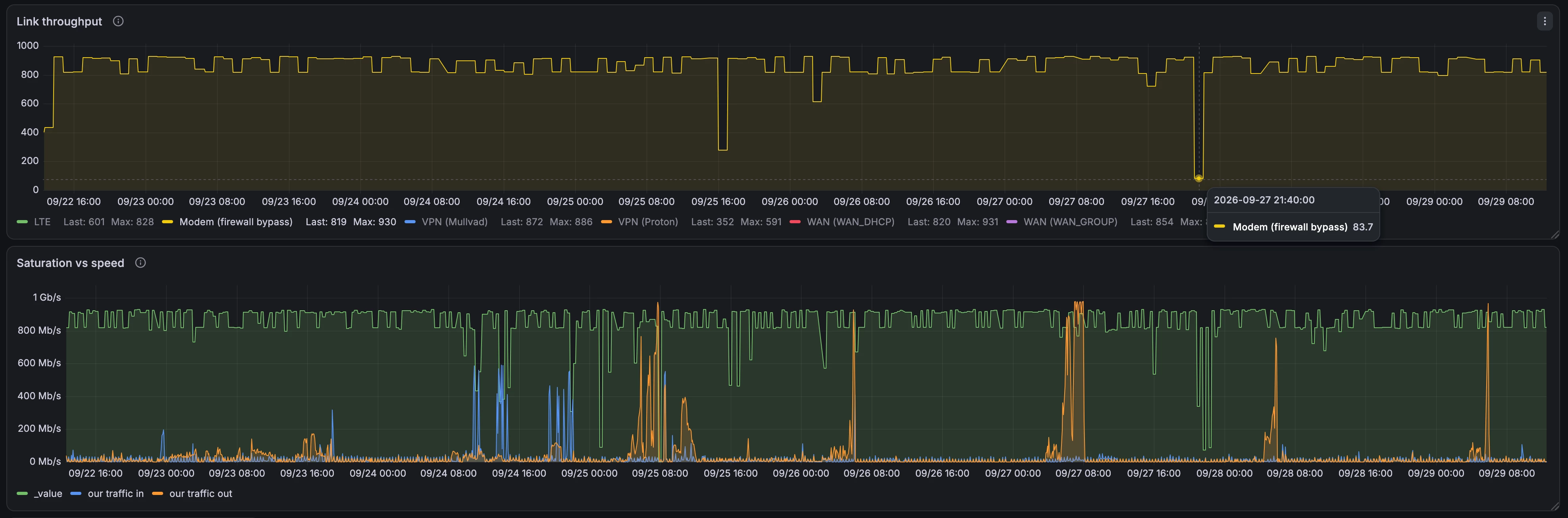

Monitoring of my KPN 1gbps vs my Odido LTE connection, never exceeding 800mbps, often below half of the hired speed
The instability and lower speeds from the hired ones in KPN prompted me to start monitoring the connection. The stability problem happened so often that I hired a backup 5g link from odido (since I work from home) and was tired of the “Restart your modem/ONT” instructions.
I installed a smart plug on my ONT so I could make the restarts without going to the meterkast every time…
I would like KPN to either take those complaints seriously and investigate it in depth, or waiver the cancelation minimum dates from contract with such unstable speeds so we can go to a better provider…
It’s usually easy to talk to support about an internet that is offline, it’s never easy to complain about unstable/unreliable connections

​@rvk01 I undersand your suggestion of the investigation path, and that has been mine for a long time, however moving away from the experia box was what brought *some* stability to the connection.
The experience was roughly this:
  • Restarting the Experia Box whenever I had an issue
  • Restart the ONT when that didn’t work
    • This is way more rare to happen, but I would say more than I would expect to
  • Get a 5G router and KPN 5G (which is metered on a daily limit but should be fine if it’s just a backup)
    • It didn’t suffice, I’d run over constantly because of the many and long unstable moments the link had
  • Realize the 5G was sustaining 40-60% packet loss
  • Moving away from the Experia Box to make a direct OpnSense conection with the ONT VLAN
    • This essetially eliminated the problem with restarting the router, it’s a 4-core/16GB RAM machine instead of the experia hardware
  • Hiring Odido’s Klik’n’Klaar as a backup link (realizing the packet loss was gone and stability of speed was higher)
  • Measuring with Grafana/InfluxDB the performance of both links from a dedicated machine
  • Realizing I have roughly daily outages around 4-6am
  • Questioning my life choices…
The amount of infrastructure fiddling was just growing because I could neither get a proper link working with relatively constant speeds around the hired plan nor be able to have support follow up on the instabilities (given the internet being up at the time of contact is enough to dismiss an outage)
As you can see the measurements and procedures are not coming from lack of knowledge (at least until now, I can always be missing a variable) but I’m really unhappy with both the hardware provided (the experia box requiring me to reboot every now and again) and the link quality (even bypassing most of the overhead from the router)
I would say my backup link has been probably more reliable than the main one
You can observe the constant dips on WAN (KPN) happen just as ofter or more than a 5G link.
Also switching to Experia (and having to restart the box over and over) will be a degradation of the service now (since I can’t have 2 ppoe flows over the same ONT) until we discover what might be going on with the link.

I have just switched back to the direct link so we can compare the performance, so far the results look promissing regarding stability
  • September 8, 2026
The results are in: The Experia box is indeed able to increase the speed average and reduce drops both in frequency and intensity, but we still see lots of them (which points to the link instability I mentioned)
Some highlights:
04/09/26 @ 5:36 - 211 Mbps
04/09/26 @ 7:12 - 134 Mbps
04/09/26 @ 11:55 - 646 Mbps
04/09/26 @ 16:54 - 627 Mbps
04/09/26 @ 19:36 - 655 Mbps
I just flagged the ones at ~40% or less of the hired speed, but there aare way more drops around the 800 Mbps marks (which I consider to be acceptable)
With a longer term metric collection, I’m expecting to find many more of those bigger gaps (as I already had in the past)

I’ve completed my profile with the data you asked, and managed to also get some more drops noted.
Since they don’t happen everyday, it’s also quite difficult to get support to check at the time they happen, so it would be nice if the history somehow helps.
13/09 07:30 - 191 Mbps
14/09 7:02 - 410 Mbps
14/09 7:42 - 152 Mbps
14/09 8:17 - 256 Mbps
14/09 8:38 - 237 Mbps
I’m also trying to work on some improvements on the measurements to correlate signals of saturation and bandwith more precisely, but I’m assuming no process I have running would be able to saturate ~700mbps of the link

This is weird because I haven’t touched the router or switched back from mine.. at the same time I see no drop in my measurements, so it might have happened and recovered in between mesurements
> The tricky thing is that I cannot measure drops in speed. This is partly because a lot of speed issues happen in the home network, and not necessarily in our connection.
I’m slowly attempting to get a correlation between link saturation and speed drops to rule that out as a cause, but it’s taking a bit long for me to have time to set that up
> a single PC connected to port 1
The problem with it is having to unplug my whole infra to make one speedtest, this is shy I’m attempting to get that correlation metric… I might also try to have it done my switching the rest of the infra to the 5G backup link, but I’ll keep you posted
> Do you experience the drops on all devices at home? So any laptops, Smart TV's and phones experiencing drops in speeds?
Yes, but I can understand those might be way more sensitive to the rest of the infra like wi-fi signals etc, this is why I am conducting the tests as close to the router as I can
> because maintenance is scheduled on the 30th, should the mechanics then find someting in our network that isn't working right (and would be causing the issues you’re experiencing), they can fix it as well.
I might say that “the worst has passed” (which was some months ago with constant drops in actual connection, not just speed), but our constant debugging is helping eliminate a couple of confounding variables and helping tune the ones I can’t escape

  • September 29, 2026
​@Sanne van KPN
I got some measurements and was able to get both a drop caused by load (the first drop around 16:00) and one not affected by it (the one around 22:00), so we can see the measurement of both dimensions are somewhat precise.
I’ll measure in the next few days the  total offload of the traffic (unfortunately I can’t keep this way for long) to see if we can measure anything different
