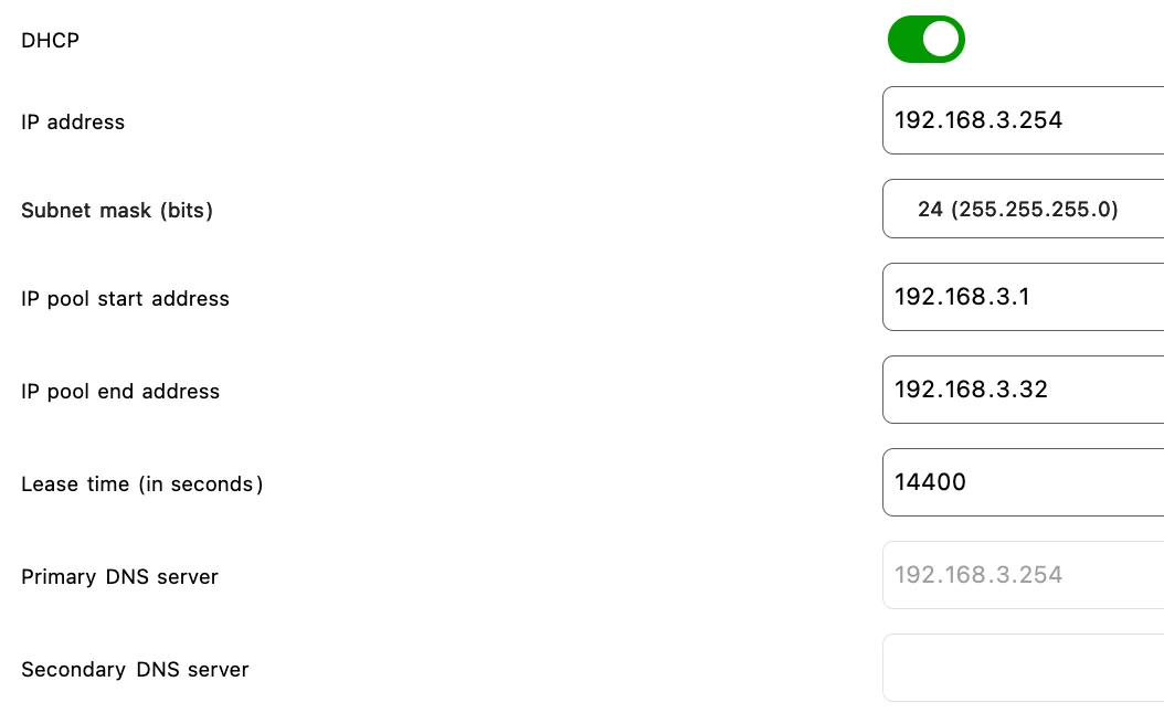

  • May 14, 2025
Home network
Guest network
  • May 14, 2025
@I K The modem settings look good. What are the wifi settings in the Huawei? Auto of static IP? Don't use static, but go to IP address reservation in the modem, and give the Huawei (MAC adres) a fixed ip address in the range 192.168.2.xxx. Can you put the screenshoot of the setting of Huawei?

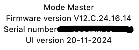

Then, circling back to the main problem of your Huawei not being able to connect to the main wifi. Or rather, connecting to the wifi, but not the internet. Which version of the KPN Software is running on your Box 12? This is listed below the image on the login page.
  • May 28, 2025
  • June 3, 2025
Right, that is the most recent version, so that is good. I'm a bit stumped as to what the problem could be. There was an IPv6 bug in the previous version, but that is no longer the case in this version. And also, you have IPv6 disabled so it's not a factor to begin with.
