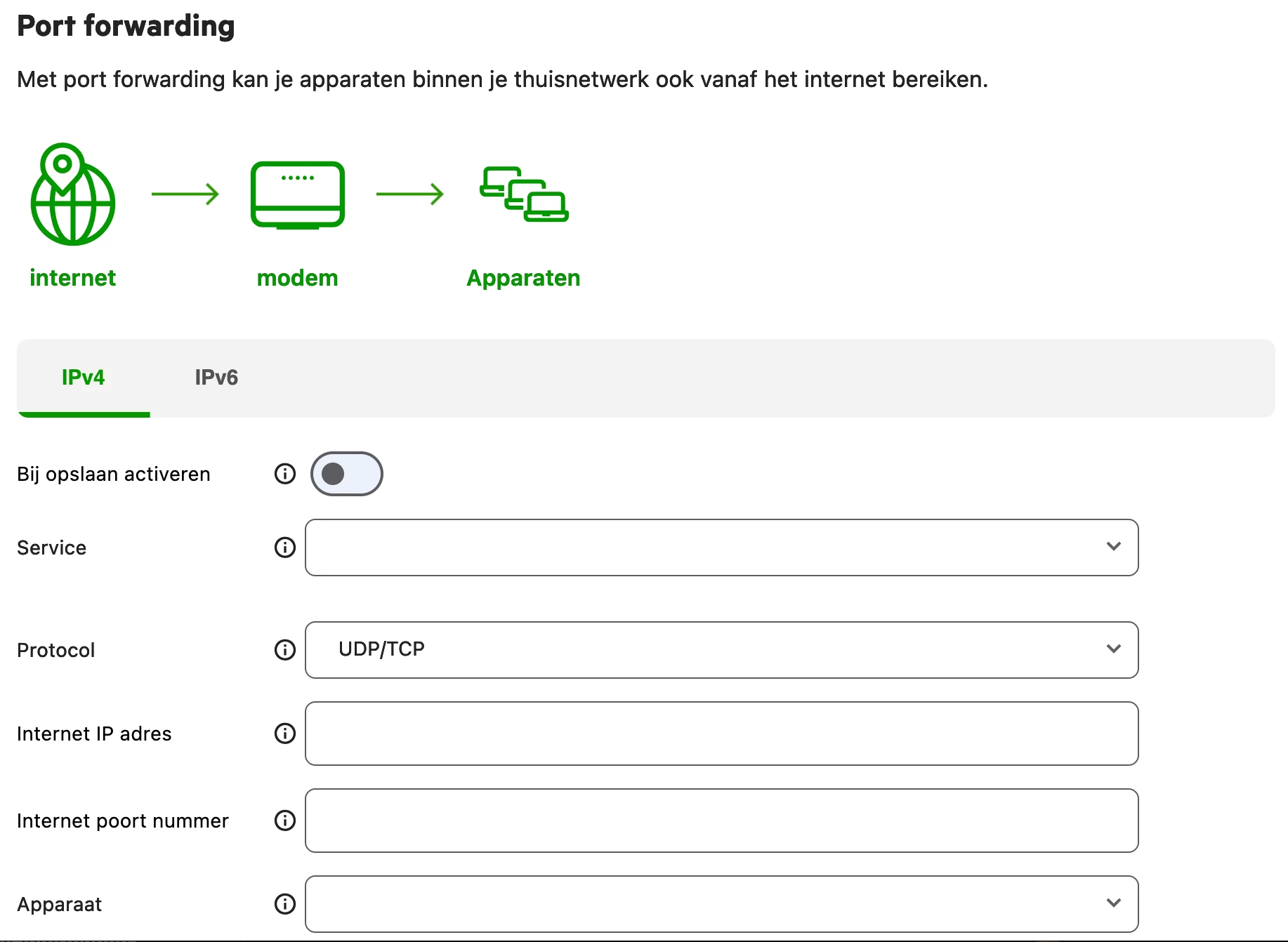

In the “port forwarding” section of the router, there is no need for OpenVPN/1194UDP entries, may be someone suggested this for troubleshooting. This is only needed if you run an own OpenVPN server. In theory (and praxis) they should not interfere, unless (may be) openvpn is configured to use port 1194 as source port. If you have such a port forwarding entry, try to switch it off, but I do not expect improvement.

If I understand ​@hmmsjan_2 correctly, I have to check the status of “Forwarding port” and it has to be off. Actually it is the case, it is by default off.
  • May 30, 2025
Port forwarding is not needed for outgoing traffic, but you didn't answer my question, which subnet does CWI use? If it overlaps with KPN subnet (default 192.168.2.0/24), a VPN connection won't work
