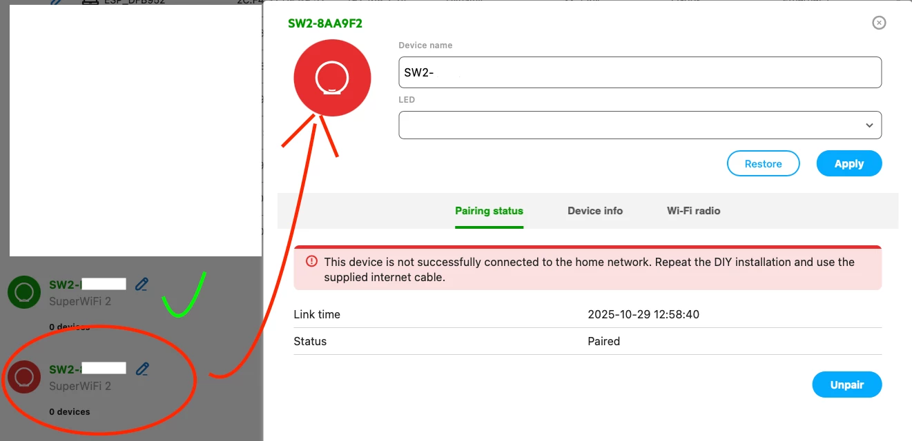

Hello.
Sorry that I need to write my question in English.
I have a similar issue with Patrick707. Instead I have wifi connection on my superwifi router. I have continues green light. The only issue is on my modem settings I see attached error.
One Superwifi router is green and Synced while the other one is indicated red, paired and have below error message.
Admin: Split off this topic and created a new topic
Hey ​@Krnvsl. Welcome to the KPN Community!
I've created a dedicated topic for your question so we can discuss your issue here. Good observation that something is going wrong with the connection of one of your SuperWifi points. Even though the SuperWifi shows a green LED, something is clearly not functioning properly. In the web interface, it shows a red status and that shows the SuperWifi is no longer working well within your mesh network.
Fortunately, you don’t need to do anything complicated to fix this. You just need to log in to the web interface, go to Instellingen, then to Systeem, and choose Herstart under Herstart Thuisnetwerk. Than it should work properly again.
Could you give it a try?

  • nov 7, 2025 12:00 a.m. UTC
HI Arjan.
Thanks a lot, it worked quite well. :)
Glad to hear that! Hopefully it will stay this way.
