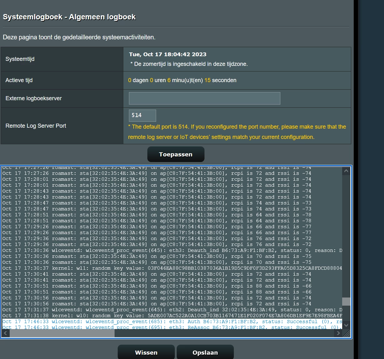

  • October 17, 2023
Het is zojuist (18:57) weer gebeurd.
Dit zegt het logboek:
Oct 17 17:46:33 wlceventd: wlceventd_proc_event(685): eth3: Auth B6:73:A9:F1:BF:B2, status: Successful (0), rssi:0
Oct 17 17:46:33 wlceventd: wlceventd_proc_event(695): eth3: ReAssoc B6:73:A9:F1:BF:B2, status: Successful (0), rssi:-68

May  5 07:05:02 kernel: merlin28_speed_set_core(): Step 10. Set core_congif_from_pcs
May  5 07:05:02 kernel: merlin28_speed_set_core(): RAM variable vco_rate is 15
May  5 07:05:02 kernel: merlin28_cfg_core_ram_var(): program core_config_word 0x1e to ram address 0x50 ...
May  5 07:05:02 kernel: merlin28_speed_set_core(): Step 9. Reset Datapath (core)
May  5 07:05:02 kernel: merline28_datapath_get_core_out_reset(): Datapath Reset (core) in progress
May  5 07:05:02 kernel: merlin28_check_pll_lock(): Checking Core #0 PLL Lock Status
May  5 07:05:02 kernel: merlin28_check_pll_lock(): PLL Locked
May  5 07:05:02 kernel: merlin28_lane_config_speed(): Step 10. Lane Configuration
May  5 07:05:02 kernel: merlin28_lane_config_speed(): Step 13.a. Configure lane registers
May  5 07:05:02 kernel: merlin28_lane_config_speed(): Step 13.b. Configure lane's micro RAM vaiables
May  5 07:05:02 kernel: merlin28_lane_config_speed(): RAM variable an_enabled is 0
May  5 07:05:02 kernel: merlin28_cfg_lane_ram_var():  program lane_config_word 0x4 to ram address 0x400 ...
May  5 07:05:02 kernel: merlin28_lane_config_speed(#2):
May  5 07:05:02 kernel: CONFIGURING FOR FORCE 1G
May  5 07:05:02 kernel: INFO merlin28_lane_config_speed(): END Merlin core #0 lane #0 Initialization procedure
May  5 07:05:02 kernel: INFO merlin28_speed_set_core(): END Merlin Initialization procedure
May  5 07:05:02 kernel: MerlinSupport::merlin28_powerup_lane(): powering up core #0x0 lane #0x0
May  5 07:05:02 kernel: INFO merlin28_serdes_init(): END Merlin Initialization procedure
May  5 07:05:02 kernel: merlin28_speed_set_core(): Step 7 Config Speed to 3
May  5 07:05:02 kernel: merlin28_lane_config_speed(#3):
May  5 07:05:02 kernel: CONFIGURING FOR FORCE 2P5G
May  5 07:05:02 kernel: No option found for: "-d ML_C_VCO_10P3125", added default value 0 in index 10
May  5 07:05:02 kernel: ^[[0;30;102m=== End of 5G Active Ethernet Initialization for core 0, lane 0 ===^[[0m
May  5 07:05:02 kernel: SYSPORT Host Binding Successfull
May  5 07:05:02 kernel: Archer CPU Affinity = 3
May  5 07:05:02 kernel: eth0      : Down          C8:7F:54:41:3B:00 IntSw:P0 Lgcl: 0 LAN PHY_ID:0x08:OnChip       NoApd    PwrDn       1 Gbps        EGPHY Cfg: ANG.  1 Gbps;             Down                   Unknown
May  5 07:05:02 kernel: eth1      : Down          C8:7F:54:41:3B:00 IntSw:P5 Lgcl: 5 LAN PHY_ID:0x06:OnChip       NoApd    PwrUp     2.5 Gbps      2_EXTSW Cfg: FIX.2.5 Gbps;             Down                                S1K2K5R:             S1K2K5R:      2500Base-X
May  5 07:05:02 kernel: <IntnlDev>:   Up   1 Gbps 00:00:00:00:00:00 IntSw:P8 Lgcl: 8
May  5 07:05:02 kernel: logical_port 0: intf_index 0, switch_index 0, phys_port 0 -> port_index 0, nbr_of_queues 8
May  5 07:05:02 kernel: logical_port 1: intf_index 0, switch_index 0, phys_port 5 -> port_index 1, nbr_of_queues 4
May  5 07:05:02 kernel: SYSPORT[0]: port[0] -> nbr_of_brcm_tags 1
May  5 07:05:02 kernel: SYSPORT[0]: port[1] -> nbr_of_brcm_tags 1
May  5 07:05:02 kernel: SYSPORT[0] = SWITCH_INTERNAL
May  5 07:05:02 kernel: RXQ[0]: IRQ 50, CPU 3
May  5 07:05:02 kernel: CSB Initialized: 0xdbf77000 (0xdbf77000), size 64 (128)
May  5 07:05:02 kernel: Ports 2, TDMA Rings 12
May  5 07:05:02 kernel: Archer DMA Layer Initialized
May  5 07:05:02 kernel: Sysport Recycle Task: IRQ 51, CPU 3
May  5 07:05:02 kernel: dgasp: kerSysRegisterDyingGaspHandler: bcmsw registered
May  5 07:05:02 kernel: bcm_enet_init_post:L2413 ENET system contructed and configured enet-kthrd thread
May  5 07:05:02 kernel: enet_kthread_handler:L297 Instantiating ENET thread
May  5 07:05:02 kernel: bcm_mcast_init successful
May  5 07:05:02 kernel: Broadcom PCIe Host Controller Driver (impl1)^M
May  5 07:05:02 kernel:   bcm-pcie: DEF CFG: ssc 0x0, speed  0x0, bootorder 0x0, apon 0x0
May  5 07:05:02 kernel:   bcm-pcie:        : pwr 0x0, errlog 0x1111, msi 0x1111, acc  0x1111, pllclkid 0x3210
May  5 07:05:02 kernel:   bcm-pcie:        : loglevel 0x1 pllclkadj 0x0
May  5 07:05:02 kernel:   bcm-pcie: [1] DT node available: pcie@85000000
May  5 07:05:02 kernel:   bcm-pcie: found Port [1] GEN0 Core Rev [1.00] with 0 Lanes^M
May  5 07:05:02 kernel:   bcm-pcie: [1] vcore [0] initialized with [2] devices^M
May  5 07:05:02 kernel:   bcm-pcie: Core [0] DT node available: pcie0
May  5 07:05:02 kernel:   bcm-pcie: found Port [0] GEN2 Core Rev [4.02] with 2 Lanes^M
May  5 07:05:02 kernel: getrcal for res select 5, int 675, ext 660, ratio 125 ratio1 140, rcal 8
May  5 07:05:02 kernel:   bcm-pcie: Core [0] setting resistor calibration value to 0x8
May  5 07:05:02 kernel:   bcm-pcie: Core [0] link is DOWN^M
May  5 07:05:02 kernel:   bcm-pcie: Core [0] dev [0] powered down^M
May  5 07:05:02 kernel: broadcomThermalDrv brcm-therm: init (CPU count 4 4 4 4)
May  5 07:05:02 kernel: brcm_otp_init entry
May  5 07:05:02 kernel: eth1 (Int switch port: 5) (Logical Port: 5) (phyId: 6) Link Up at 2500 mbps full duplex
May  5 07:05:02 kernel: init rtk switch rtl8367s_init:1162
May  5 07:05:02 kernel: [rtk_ext_swctl_init]: reset ext switch
May  5 07:05:02 kernel: rtk_switch_init: set to chip defaults.
May  5 07:05:02 kernel: smi_write, mdc/mdio phy_id=29
May  5 07:05:02 kernel: init switch rtk_switch_probe, get chip_num:6367, chip_ver:a0
May  5 07:05:02 kernel: read 0x1202 test:
May  5 07:05:02 kernel: [rtk_switch_probe]: reg[0x1202] = [88a8]
May  5 07:05:02 kernel: init switch _rtk_switch_init:740, 0
May  5 07:05:02 kernel: [rtk_ext_swctl_init]: init switch ---try:1
May  5 07:05:02 kernel: init switch rtk_ext_swctl_init:335---port:16,mode:10, linkstatus:1
May  5 07:05:02 kernel: init switch rtk_ext_swctl_init:357---cpuport:16,mode:2
May  5 07:05:02 kernel: rtk_switch_maxPktLenCfg_get(): return 0
May  5 07:05:02 kernel: current rtk_switch_maxPktLen: 16368
May  5 07:05:02 kernel: rtk_switch_maxPktLenCfg_set(): return 0
May  5 07:05:02 kernel: rtk_switch_greenEthernet_get(): return 0
May  5 07:05:02 kernel: current rtk_switch_greenEthernet state: 1
May  5 07:05:02 kernel: rtk_switch_greenEthernet_set(): return 0
May  5 07:05:02 kernel: vlan_accept_none
May  5 07:05:02 kernel: emf: Unknown symbol osl_malloc (err -2)
May  5 07:05:02 kernel: emf: Unknown symbol osl_pktdup_cpy (err -2)
May  5 07:05:02 kernel: emf: Unknown symbol osl_mfree (err -2)
May  5 07:05:02 kernel: emf: Unknown symbol linux_pktfree (err -2)
May  5 07:05:02 kernel: emf: Unknown symbol osl_pktdup (err -2)
May  5 07:05:02 kernel: igs: Unknown symbol emfc_wmf_scbfind (err -2)
May  5 07:05:02 kernel: igs: Unknown symbol osl_malloc (err -2)
May  5 07:05:02 kernel: igs: Unknown symbol emfc_mfdb_ipv6_membership_add (err -2)
May  5 07:05:02 kernel: igs: Unknown symbol osl_detach (err -2)
May  5 07:05:02 kernel: igs: Unknown symbol emfc_rtport_del (err -2)
May  5 07:05:02 kernel: igs: Unknown symbol emfc_igmp_snooper_register (err -2)
May  5 07:05:02 kernel: igs: Unknown symbol osl_attach (err -2)
May  5 07:05:02 kernel: igs: Unknown symbol emfc_mfdb_ipv6_membership_del (err -2)
May  5 07:05:02 kernel: igs: Unknown symbol emfc_wmf_get_igsc (err -2)
May  5 07:05:02 kernel: igs: Unknown symbol emfc_rtport_add (err -2)
May  5 07:05:02 kernel: igs: Unknown symbol emfc_igmp_snooper_unregister (err -2)
May  5 07:05:02 kernel: igs: Unknown symbol emfc_mfdb_membership_del (err -2)
May  5 07:05:02 kernel: igs: Unknown symbol osl_mfree (err -2)
May  5 07:05:02 kernel: igs: Unknown symbol emfc_mfdb_membership_add (err -2)
May  5 07:05:02 kernel: Archer TCP Pure ACK Enabled
May  5 07:05:02 kernel: Loading wlshared Module...
May  5 07:05:02 kernel: cfg80211: Loading compiled-in X.509 certificates for regulatory database
May  5 07:05:02 kernel: cfg80211: Loaded X.509 cert 'sforshee: 00b28ddf47aef9cea7'
May  5 07:05:02 kernel: platform regulatory.0: Direct firmware load for regulatory.db failed with error -2
May  5 07:05:02 kernel: Loading HND Module
May  5 07:05:02 kernel: igs_module_init:840:     IGS 29 create network socket successful
May  5 07:05:02 kernel: osl_skb_audit: PASS
May  5 07:05:02 kernel: wl_module_init: passivemode set to 0x1
May  5 07:05:02 kernel: wl_module_init: txworkq set to 0x0
May  5 07:05:02 kernel: ^[[0;32mwl_pktfwd_sys_init:  ^[[1m^[[34mWL_PKTFWD[1.1.0]^[[0m Success^[[0m
May  5 07:05:02 kernel: si_doattach: using BAR0 value: enum_base=85000000
May  5 07:05:02 kernel: BME Service Initialization
May  5 07:05:02 kernel: BME: M2M Core id 0x844 rev 132
May  5 07:05:02 kernel: M2M Service Initialization: M2M_DD_ENAB 0x00000003
May  5 07:05:02 kernel: M2M: M2M Core id 0x844 rev 132
May  5 07:05:02 kernel: M2M: SUCCESS eng 0 alloc rings <5e1dbc19,b0f45a1d>,b9281262 depth 256
May  5 07:05:02 kernel: M2M: SUCCESS eng 1 alloc rings <9beccc03,e326b6c2>,b3a5389c depth 256
May  5 07:05:02 kernel: M2M: DMA 0 IntRcvLazy 01000000
May  5 07:05:02 kernel: M2M: DMA 0 RcvCtrl XmtCtrl enabled
May  5 07:05:02 kernel: M2M: DMA 1 IntRcvLazy 01000000
May  5 07:05:02 kernel: M2M: DMA 1 RcvCtrl XmtCtrl enabled
May  5 07:05:02 kernel: wl0: wlc_ap_attach dynamic_ed_thresh_enable = 0
May  5 07:05:02 kernel: BME:register key<1010804> user RLM sel IDX set 1 mem 4 8 hi 0 0
May  5 07:05:02 kernel: CSIMON module registered
May  5 07:05:02 kernel: wl0_awl attach successful tx: 1, rx: 2
May  5 07:05:02 kernel: WL_FLCTL[0] bpm_total_skb 17236, exhaustion_hi 1723, exhaustion_lo 4309, prio_favor 4
May  5 07:05:02 kernel: ^[[0;34mArcher WLAN Bind: eth%d, wl_radio_idx 0, radio_index 0, mode SKB^[[0m
May  5 07:05:02 kernel: Archer WLAN XFER Thread 0 Initialized
May  5 07:05:02 kernel: ^[[0;32mwl_wfd_bind: wl0 wfd_idx 0 success^[[0m
May  5 07:05:02 kernel: eth2: Broadcom BCM6756 802.11 Wireless Controller 17.10.188.6401 (r808804)
May  5 07:05:02 kernel: dgasp: kerSysRegisterDyingGaspHandler: eth2 registered
May  5 07:05:02 kernel: si_doattach: using BAR0 value: enum_base=86000000
May  5 07:05:02 kernel: M2M: SUCCESS eng 0 alloc rings <d3453601,805da434>,69f5c1a8 depth 256
May  5 07:05:02 kernel: M2M: SUCCESS eng 1 alloc rings <2f7bb36c,92cd0511>,d7168703 depth 256
May  5 07:05:02 kernel: wl1: wlc_ap_attach dynamic_ed_thresh_enable = 0
May  5 07:05:02 kernel: wl1_awl attach successful tx: 1, rx: 2
May  5 07:05:02 kernel: WL_FLCTL[1] bpm_total_skb 17236, exhaustion_hi 1723, exhaustion_lo 4309, prio_favor 4
May  5 07:05:02 kernel: ^[[0;34mArcher WLAN Bind: eth%d, wl_radio_idx 1, radio_index 1, mode SKB^[[0m
May  5 07:05:02 kernel: Archer WLAN XFER Thread 1 Initialized
May  5 07:05:02 kernel: ^[[0;32mwl_wfd_bind: wl1 wfd_idx 1 success^[[0m
May  5 07:05:02 kernel: eth3: Broadcom BCM6756 802.11 Wireless Controller 17.10.188.6401 (r808804)
May  5 07:05:02 kernel: dgasp: kerSysRegisterDyingGaspHandler: eth3 registered
May  5 07:05:02 kernel: bcm_bca_usb_ctrl_probe: usb3_enable 1 xhci_enable 1
May  5 07:05:02 kernel: hub 1-0:1.0: config failed, hub doesn't have any ports! (err -19)
May  5 07:05:03 kernel: eth1 (Int switch port: 5) (Logical Port: 5) (phyId: 6) Link Up at 2500 mbps full duplex
May  5 07:05:03 kernel: CSIMON:  CSIMON[1.1.0] Initialization
May  5 07:05:03 kernel: Wowl not supported (-23)
May  5 07:05:03 kernel: wl0: wlc_ulmu_sw_trig_enable: HE UL-OFDMA not enabled
May  5 07:05:03 kernel: CSIMON: M2M usr already registered ...
May  5 07:05:05 rc_service: service 1943:notify_rc restart_firewall
May  5 07:05:05 kernel: wl0: wlc_ulmu_sw_trig_enable: HE UL-OFDMA not enabled
May  5 07:05:05 kernel: CSIMON:  CSIMON[1.1.0] Initialization
May  5 07:05:05 kernel: CSIMON: M2M usr already registered ...
May  5 07:05:05 kernel: In wl_dfs_cac_notify_status chanspec 0x1001 DFS state 0
May  5 07:05:08 WAN Connection: WAN(0) link down.
May  5 07:05:10 kernel: CSIMON:  CSIMON[1.1.0] Initialization
May  5 07:05:10 kernel: CSIMON: M2M usr already registered ...
May  5 07:05:10 kernel: In wl_dfs_cac_notify_status chanspec 0xe02a DFS state 0
May  5 07:05:14 wlceventd: main(1239): wlceventd Start...
May  5 07:05:14 acsd: eth2: Selecting 2g band ACS policy
May  5 07:05:14 kernel: power up LAN ports
May  5 07:05:14 RT-AX58U: start httpd:80
May  5 07:05:14 avahi-daemon[2053]: WARNING: No NSS support for mDNS detected, consider installing nss-mdns!
May  5 07:05:15 httpd: Save SSL certificate...80
May  5 07:05:15 httpd: mssl_cert_key_match : PASS
May  5 07:05:15 disk monitor: be idle
May  5 07:05:15 hour monitor: daemon is starting
May  5 07:05:15 hour monitor: daemon terminates
May  5 07:05:15 miniupnpd: it is advised to use network interface name instead of 192.168.1.1/255.255.255.0
May  5 07:05:15 miniupnpd[2089]: HTTP listening on port 40941
May  5 07:05:15 miniupnpd[2089]: Listening for NAT-PMP/PCP traffic on port 5351
May  5 07:05:15 httpd: Succeed to init SSL certificate...80
May  5 07:05:15 avahi-daemon[2053]: Alias name "RT-AX58U" successfully established.
May  5 07:05:17 kernel: SCSI subsystem initialized
May  5 07:05:17 modprobe: module scsi_wait_scan not found in modules.dep
May  5 07:05:17 modprobe: module mbcache not found in modules.dep
May  5 07:05:17 modprobe: module jbd not found in modules.dep
May  5 07:05:17 modprobe: module ext3 not found in modules.dep
May  5 07:05:17 modprobe: module ext4 not found in modules.dep
May  5 07:05:17 modprobe: module ext2 not found in modules.dep
May  5 07:05:17 kernel: tfat: loading out-of-tree module taints kernel.
May  5 07:05:18 modprobe: module btusbdrv not found in modules.dep
May  5 07:05:18 ahs: [read_json]Update ahs JSON file.
May  5 07:05:18 Mastiff: init
May  5 07:05:18 init: fwver: 3.0.0.4_388_23556-gfef4962 (sn:NBIG50304337GNC /ha:C8:7F:54:41:3B:00 )
May  5 07:05:18 acsd: eth2: selected channel spec: 0x1003 (3)
May  5 07:05:18 acsd: eth2: Adjusted channel spec: 0x1003 (3)
May  5 07:05:18 acsd: eth3: Selecting 5g band ACS policy
May  5 07:05:18 kernel: wl0: random key value: 9D4F09D243D39A3F50D800BAC00DC11644472613C16C0F0C50F2AA52477BE978
May  5 07:05:18 wlceventd: wlceventd_proc_event(645): eth2: Deauth_ind 3C:8D:20:33:32:E2, status: 0, reason: QSTA is leaving the QBSS (or restting) (24), rssi:0
May  5 07:05:18 wlceventd: wlceventd_proc_event(662): eth2: Disassoc 3C:8D:20:33:32:E2, status: 0, reason: Disassociated because sending station is leaving (or has left) BSS (8), rssi:0
May  5 07:05:19 kernel: sched: RT throttling activated
May  5 07:05:21 kernel: eth0 (Int switch port: 0) (Logical Port: 0) (phyId: 8) Link Up at 1000 mbps full duplex
May  5 07:05:23 wan: finish adding multi routes
May  5 07:05:25 acsd: eth3: selected channel spec: 0xe07a (116/80)
May  5 07:05:25 acsd: eth3: Adjusted channel spec: 0xe07a (116/80)
May  5 07:05:25 miniupnpd[2089]: shutting down MiniUPnPd
May  5 07:05:25 miniupnpd: it is advised to use network interface name instead of 192.168.1.1/255.255.255.0
May  5 07:05:25 miniupnpd[2387]: HTTP listening on port 41235
May  5 07:05:25 miniupnpd[2387]: Listening for NAT-PMP/PCP traffic on port 5351
May  5 07:05:25 kernel: Archer TCP Pure ACK Enabled
May  5 07:05:25 rc_service: udhcpc_wan 2322:notify_rc stop_samba
May  5 07:05:25 rc_service: udhcpc_wan 2322:notify_rc start_samba
May  5 07:05:25 rc_service: waitting "stop_samba" via udhcpc_wan ...
May  5 07:05:25 Samba Server: smb daemon is stopped
May  5 07:05:25 roamast: ROAMING Start...
May  5 07:05:25 kernel: In wl_dfs_cac_notify_status chanspec 0xe07a DFS state 1
May  5 07:05:26 dhcp client: bound 192.168.2.1/255.255.255.0 via 192.168.2.254 for 86400 seconds.
May  5 07:05:28 WAN Connection: WAN was restored.
May  5 07:05:29 ntp: start NTP update
Oct 17 17:59:07 rc_service: ntp 2367:notify_rc restart_diskmon
Oct 17 17:59:07 disk_monitor: Finish
Oct 17 17:59:07 disk monitor: be idle
Oct 17 17:59:11 wlceventd: wlceventd_proc_event(685): eth2: Auth B6:73:A9:F1:BF:B2, status: Successful (0), rssi:0
Oct 17 17:59:11 wlceventd: wlceventd_proc_event(695): eth2: ReAssoc B6:73:A9:F1:BF:B2, status: Successful (0), rssi:-61
Oct 17 17:59:38 crond[2028]: time disparity of 2867754 minutes detected
Oct 17 17:59:50 kernel: wl0: random key value: F7DEB5EFA8C32DA43C0E03AA144773C1DD96AD013E4D0DFCBA315BA49E432262
Oct 17 17:59:50 wlceventd: wlceventd_proc_event(645): eth2: Deauth_ind B6:73:A9:F1:BF:B2, status: 0, reason: Unspecified reason (1), rssi:0
Oct 17 17:59:50 wlceventd: wlceventd_proc_event(685): eth2: Auth B6:73:A9:F1:BF:B2, status: Successful (0), rssi:0
Oct 17 17:59:50 wlceventd: wlceventd_proc_event(695): eth2: ReAssoc B6:73:A9:F1:BF:B2, status: Successful (0), rssi:-55
Oct 17 18:00:07 disk_monitor: Got SIGALRM...
Oct 17 18:00:36 wlceventd: wlceventd_proc_event(645): eth2: Deauth_ind B6:73:A9:F1:BF:B2, status: 0, reason: Disassociated due to inactivity (4), rssi:-69
Oct 17 18:00:37 kernel: wl0: random key value: 91B5A99F3497A5121827011B167955B8C4080F7E602F061FE7EEBAC5530CBADF
Oct 17 18:00:52 WATCHDOG: [FAUPGRADE][auto_firmware_check:(7789)]periodic_check AM 5:56
Oct 17 18:00:52 WATCHDOG: [FAUPGRADE][auto_firmware_check:(7833)]do webs_update
Oct 17 18:01:02 WATCHDOG: [FAUPGRADE][auto_firmware_check:(7851)]retrieve firmware information
Oct 17 18:01:02 WATCHDOG: [FAUPGRADE][auto_firmware_check:(7866)]fimrware update check first time
Oct 17 18:01:02 WATCHDOG: [FAUPGRADE][auto_firmware_check:(7897)]no need to upgrade firmware
Oct 17 18:01:07 ahs: [read_json]Update ahs JSON file.
Oct 17 18:02:13 wlceventd: wlceventd_proc_event(685): eth2: Auth B6:73:A9:F1:BF:B2, status: Successful (0), rssi:0
Oct 17 18:02:13 wlceventd: wlceventd_proc_event(695): eth2: ReAssoc B6:73:A9:F1:BF:B2, status: Successful (0), rssi:-73
  • October 17, 2023
Het lijkt wel of hij zichzelf reset want Actieve tijd begint dan weer opnieuw?
Forum|alt.badge.img+5
  • October 18, 2023
Hoi @Joost Dekkers, het lijkt erop dat de router zichzelf herstart, want de actieve tijd dient veel hoger te liggen. Dus ik zou hem er eens tussenuit halen en de KPN ExperiaBox hetzelfde SSID te laten uitzenden, en kijken of het dan wel goed blijft gaan.
  • October 18, 2023
Gisteravond heb ik alles van KPN nog een keer gereset en ik zal de router nu in de gaten houden of hij zichzelf niet reset inderdaad.
Ik kan dat anders nog wel proberen van de KPN Experiabox, in het verleden wel gebruikt maar ik was er niet helemaal tevreden over en daarom een Router tussen gezet.
  • October 18, 2023
De asus router viel weer uit vanavond dus was er helemaal klaar mee. Heb hem er tussenuit gehaald en de Xperia 12 box ingesteld als hoofd router.
De asus router boven staat in AP modus (Access point). We gaan even kijken of dit goed gaat nu….
Blijft wel vreemd waarom de Asus beneden (vrij nieuwe zelfs) af en toe herstart.
