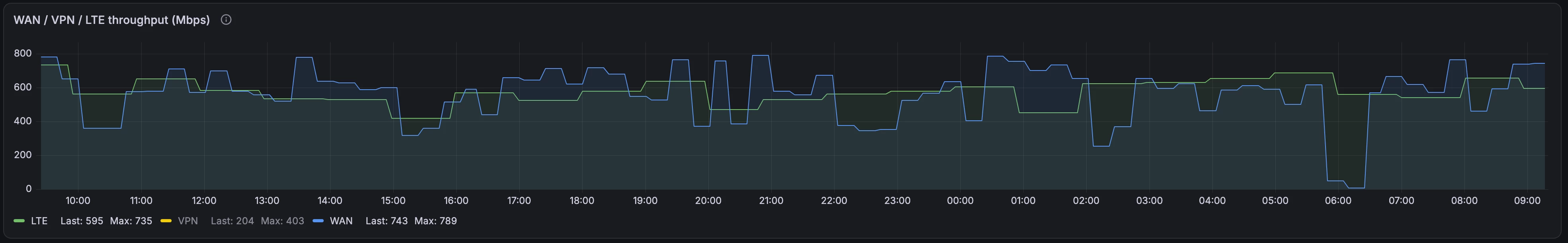

  • September 1, 2026
Monitoring of my KPN 1gbps vs my Odido LTE connection, never exceeding 800mbps, often below half of the hired speed
The instability and lower speeds from the hired ones in KPN prompted me to start monitoring the connection. The stability problem happened so often that I hired a backup 5g link from odido (since I work from home) and was tired of the “Restart your modem/ONT” instructions.
I installed a smart plug on my ONT so I could make the restarts without going to the meterkast every time…
I would like KPN to either take those complaints seriously and investigate it in depth, or waiver the cancelation minimum dates from contract with such unstable speeds so we can go to a better provider…
It’s usually easy to talk to support about an internet that is offline, it’s never easy to complain about unstable/unreliable connections
You might want to start your own topic for this, or maybe a moderator can create it from your post.
If I look at your measurements, on the WAN port (KPN?) you’re not even getting 940Mbps as you should on fiber. It’s also not clear if you’re using the KPN hardware or your own. So this first needs to be investigated with the single ONT, KPN router (Box 12?) and a single PC connected to port 1. Then do a simple speedtest and see if it reaches the 940Mbps consistently.
