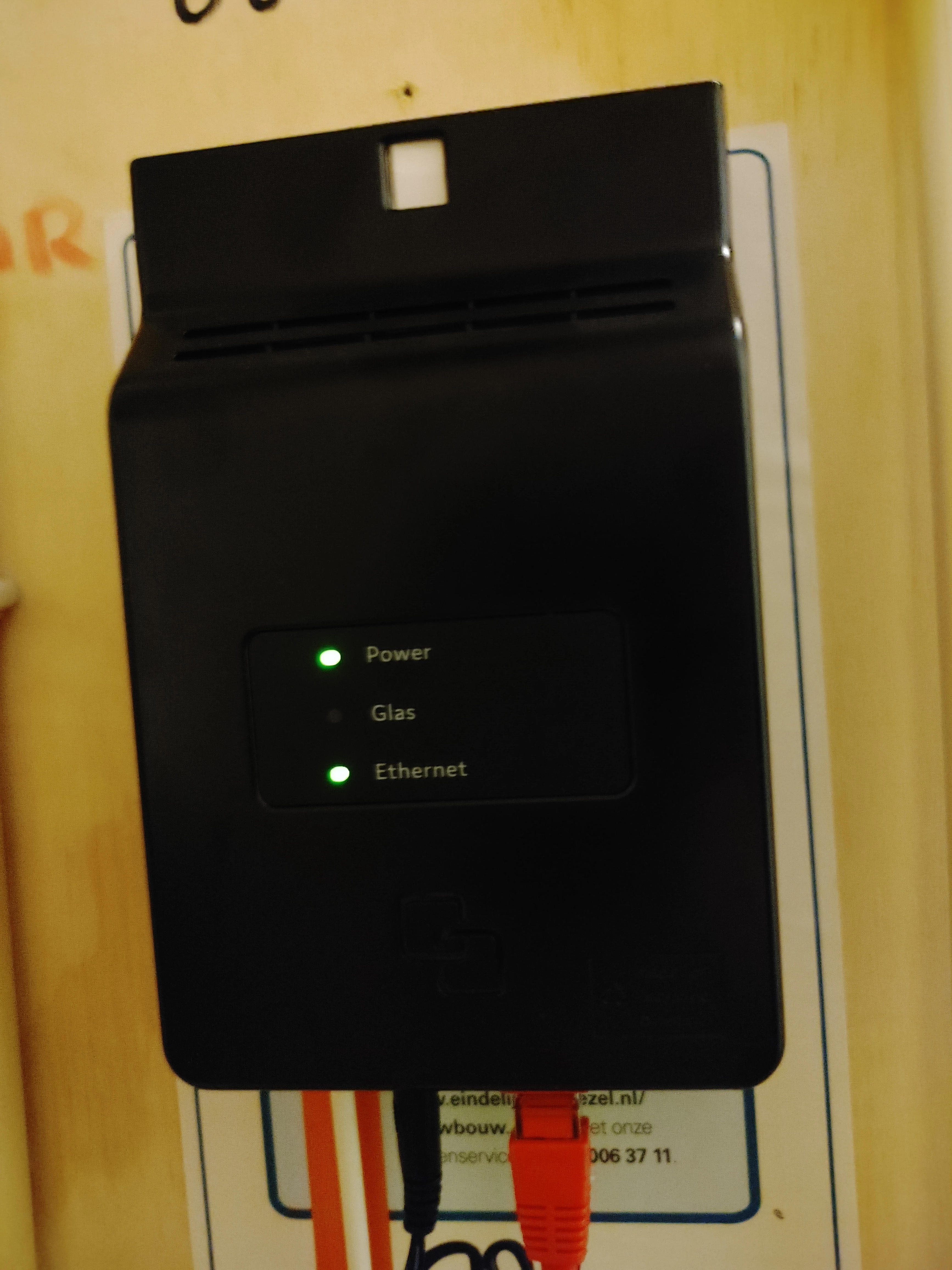

@Maja van KPN  thank you.
not sure if things got even worse but today i had no internet at all, and now the glasfiber box is also not turning on. the "glas”light is off while the others are on.
tried to unplug all and wait a bit like we did the other day, but nothing is happening and there is just no internet coming in at all😫
  • June 20, 2026
@Maja van KPN
hello, i have received the new adapter and installed it, however as i mentioned in the previous post, there is just no internet coming in at all from the glassfiber box as you can see from the photo below.
i have already tried multiple times to power it off, wait the 2 mins, and power it on again, but nothing is happening. can we please sort this out? is getting really annoying by now..
  • June 20, 2026
Your fiber-optic connection is down. It's possible that the ONT isn't making proper contact with the FTU, or the problem is in the cable between the FTU and the neighborhood exchange. You can check your connection via https://www.kpn.com/service/internet/geen-internet and order a technician.
