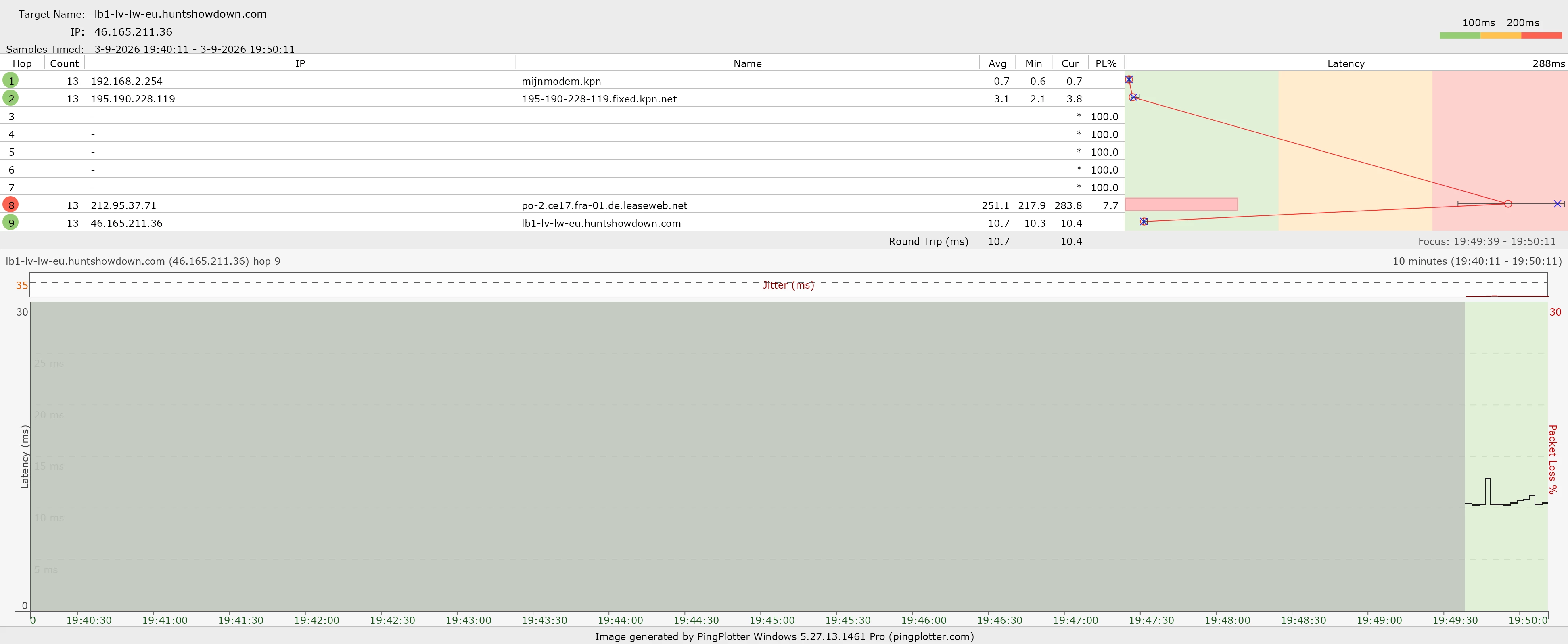

Hierbij de data van Pingplotter, allemaal tijdens de hoge ping:
Hunt:
Target Name: lb1-lv-lw-eu.huntshowdown.com
         IP: 46.165.211.36
  Date/Time: 3-9-2026 19:40:11 - 3-9-2026 19:50:11
Hop  Sent  PL%     Min     Max     Avg  Host Name / [IP]
  1    13    0    0.55    1.25    0.67  mijnmodem.kpn [192.168.2.254]
  2    13    0    2.12    7.45    3.11  195-190-228-119.fixed.kpn.net [195.190.228.119]
  3    13  100       *       *       *   [-]
  4    13  100       *       *       *   [-]
  5    13  100       *       *       *   [-]
  6    13  100       *       *       *   [-]
  7    13  100       *       *       *   [-]
  8    13    8  217.91  288.07  251.14  po-2.ce17.fra-01.de.leaseweb.net [212.95.37.71]
  9    13    0   10.25   12.85   10.67  lb1-lv-lw-eu.huntshowdown.com [46.165.211.36]

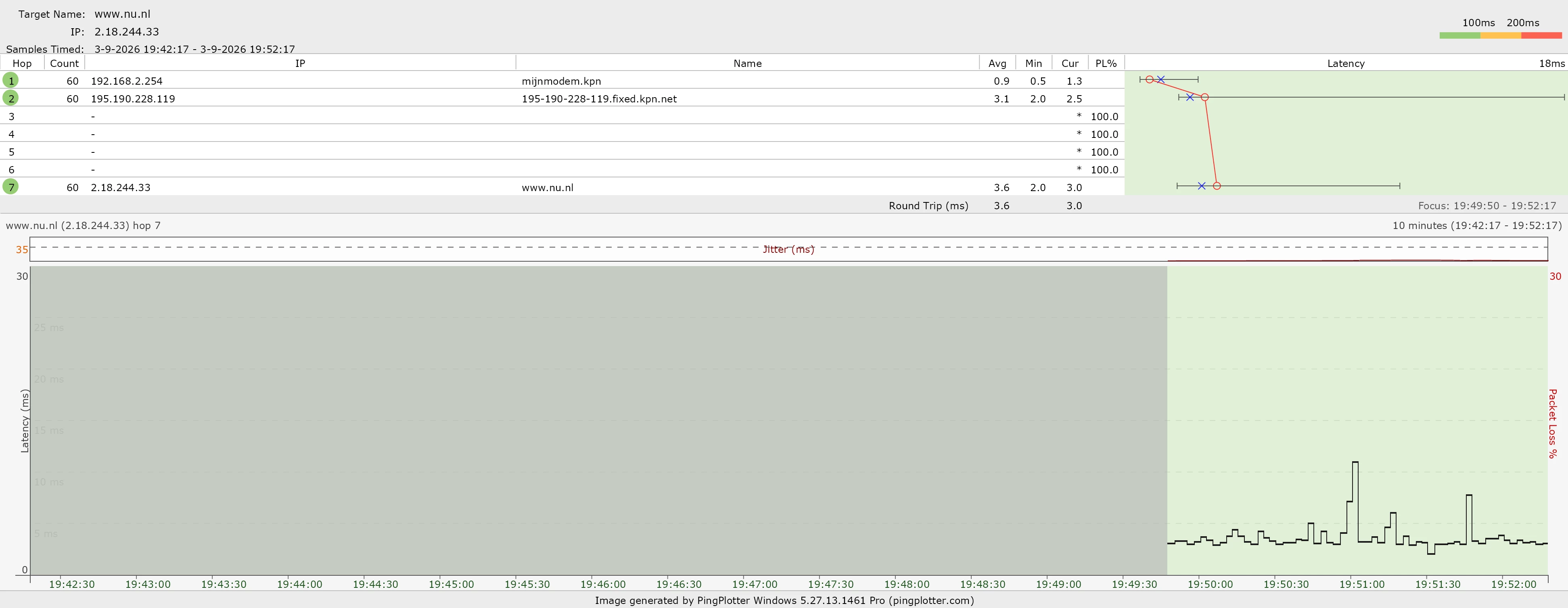

Target Name: www.nu.nl
         IP: 2.18.244.33
  Date/Time: 3-9-2026 19:41:35 - 3-9-2026 19:51:35
  1    43    0  0.49   2.85  0.88  mijnmodem.kpn [192.168.2.254]
  2    43    0  2.06  17.61  3.20  195-190-228-119.fixed.kpn.net [195.190.228.119]
  3    42  100     *      *     *   [-]
  4    42  100     *      *     *   [-]
  5    42  100     *      *     *   [-]
  6    42  100     *      *     *   [-]
  7    43    0  2.00  10.97  3.66  www.nu.nl [2.18.244.33]

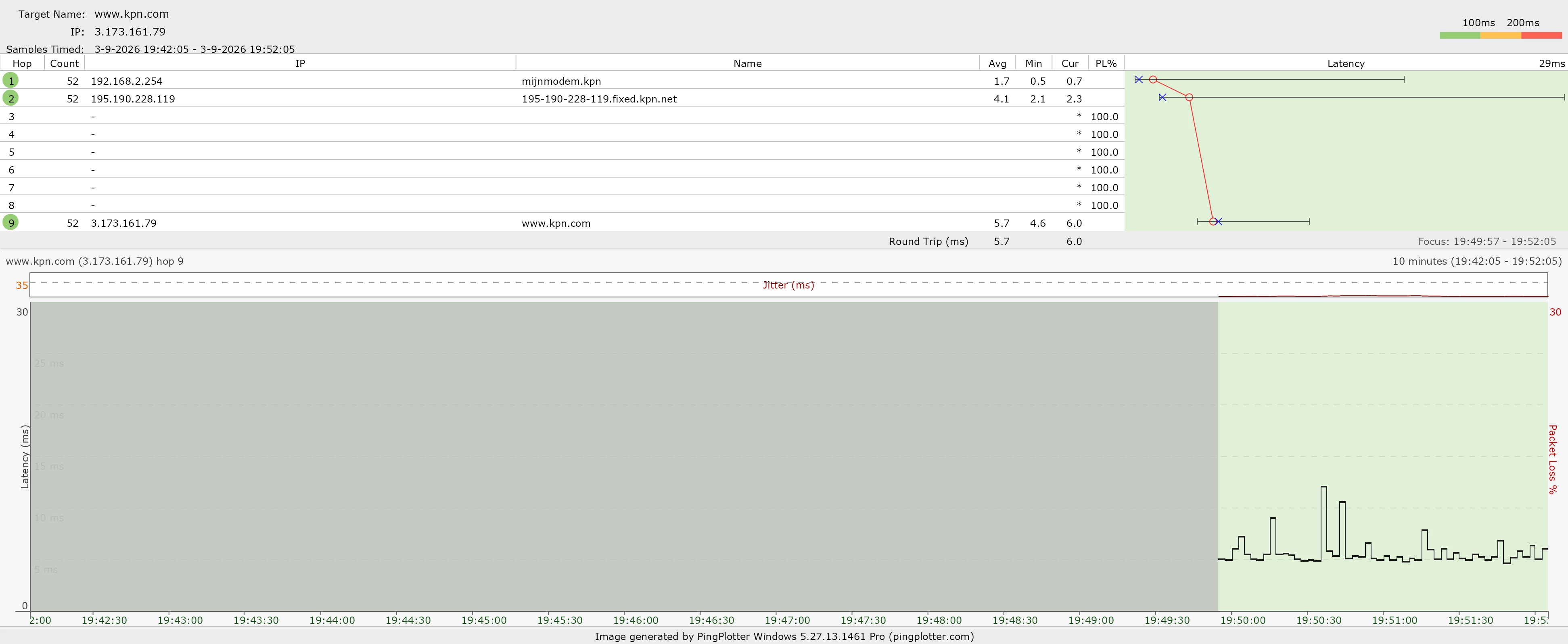

KPN:
Target Name: www.kpn.com
         IP: 3.173.161.79
  Date/Time: 3-9-2026 19:41:57 - 3-9-2026 19:51:57
  1    49    0  0.51  18.41  1.71  mijnmodem.kpn [192.168.2.254]
  2    49    0  2.12  28.98  4.16  195-190-228-119.fixed.kpn.net [195.190.228.119]
  3    48  100     *      *     *   [-]
  4    48  100     *      *     *   [-]
  5    48  100     *      *     *   [-]
  6    48  100     *      *     *   [-]
  7    48  100     *      *     *   [-]
  8    48  100     *      *     *   [-]
  9    49    0  4.59  12.06  5.66  www.kpn.com [3.173.161.79]

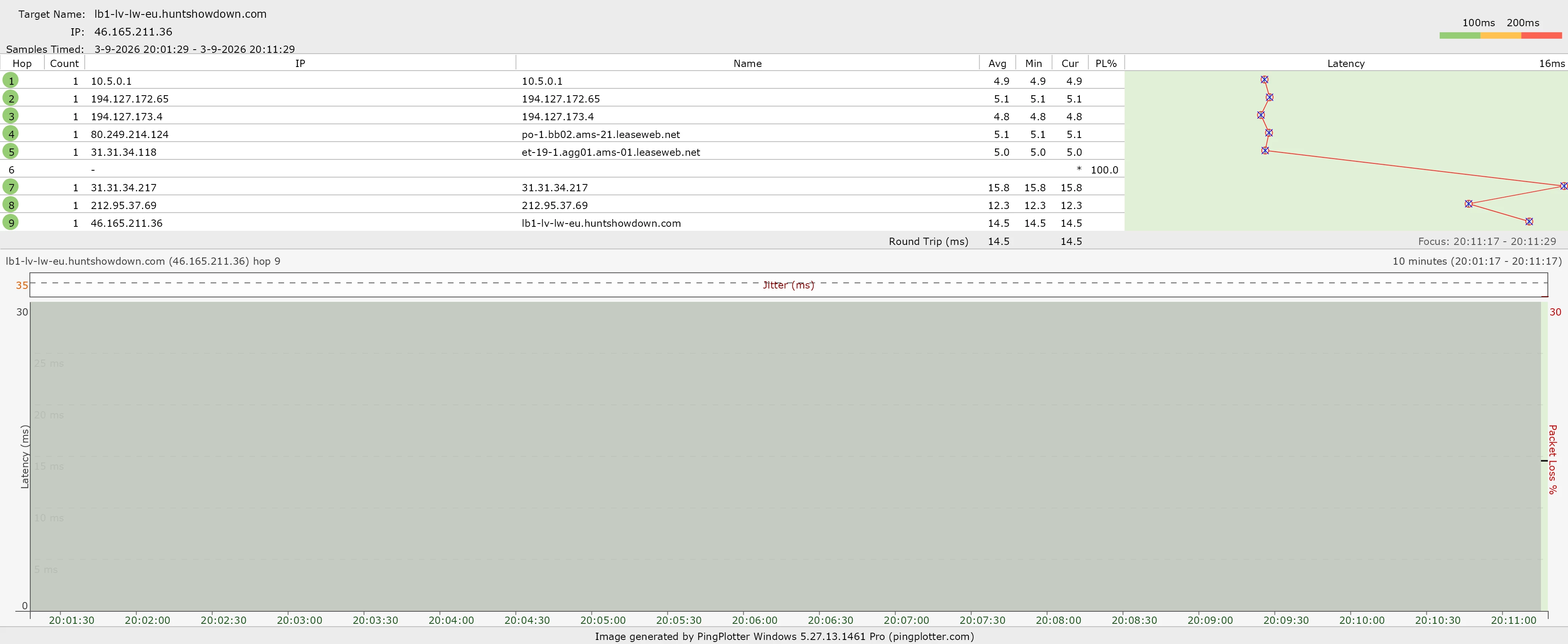

Heb ook even 1 gemaakt met VPN aan:
Hunt:
         IP: 46.165.211.36
  Date/Time: 3-9-2026 20:01:34 - 3-9-2026 20:11:34
  1     1    0   4.95   4.95   4.95  10.5.0.1 [10.5.0.1]
  2     1    0   5.13   5.13   5.13  194.127.172.65 [194.127.172.65]
  3     1    0   4.82   4.82   4.82  194.127.173.4 [194.127.173.4]
  4     1    0   5.11   5.11   5.11  po-1.bb02.ams-21.leaseweb.net [80.249.214.124]
  5     1    0   4.97   4.97   4.97  et-19-1.agg01.ams-01.leaseweb.net [31.31.34.118]
  6     1  100      *      *      *   [-]
  7     1    0  15.79  15.79  15.79  31.31.34.217 [31.31.34.217]
  8     1    0  12.34  12.34  12.34  po-1.ce18.fra-01.de.leaseweb.net [212.95.37.69]
  9     1    0  14.53  14.53  14.53  lb1-lv-lw-eu.huntshowdown.com [46.165.211.36]

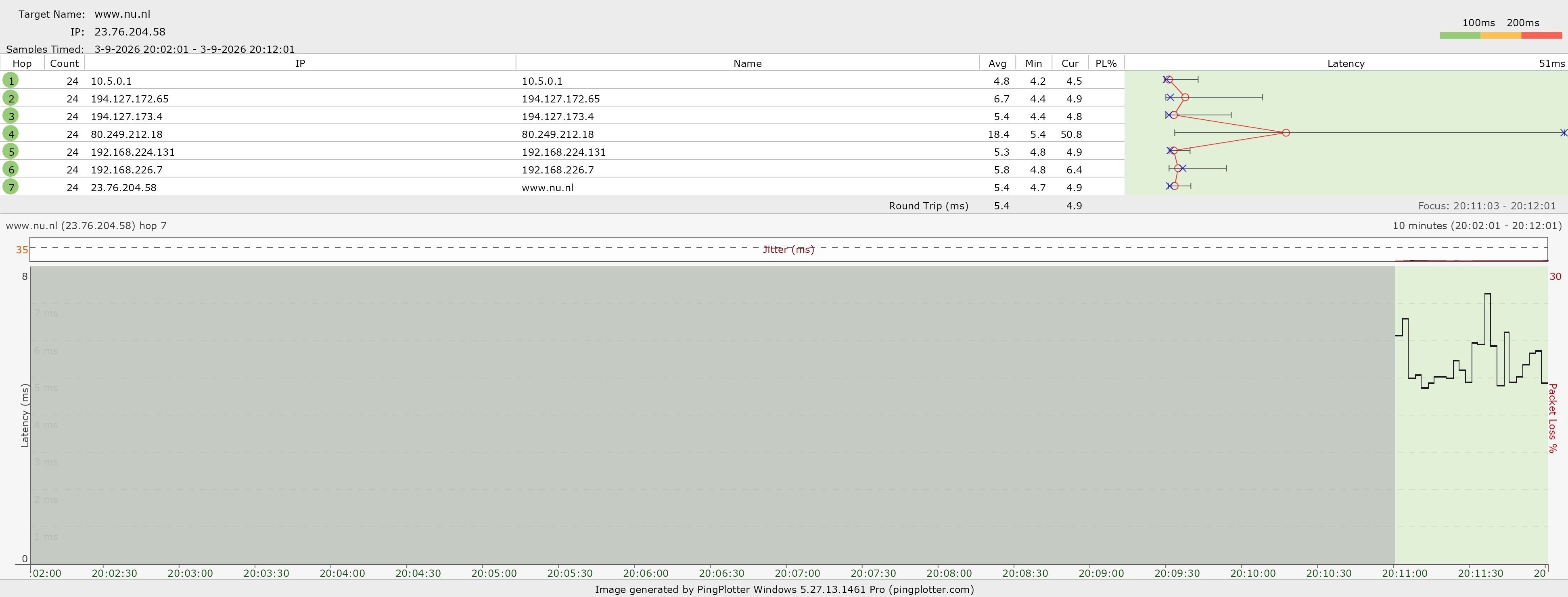

Nu.nl
         IP: 23.76.204.58
  Date/Time: 3-9-2026 20:02:01 - 3-9-2026 20:12:01
  1    24    0  4.19   8.17   4.77  10.5.0.1 [10.5.0.1]
  2    24    0  4.45  15.68   6.67  194.127.172.65 [194.127.172.65]
  3    24    0  4.37  12.04   5.35  194.127.173.4 [194.127.173.4]
  4    24    0  5.44  50.76  18.40  80.249.212.18 [80.249.212.18]
  5    24    0  4.77   7.23   5.33  192.168.224.131 [192.168.224.131]
  6    24    0  4.83  11.42   5.84  192.168.226.7 [192.168.226.7]
  7    24    0  4.74   7.28   5.44  www.nu.nl [23.76.204.58]

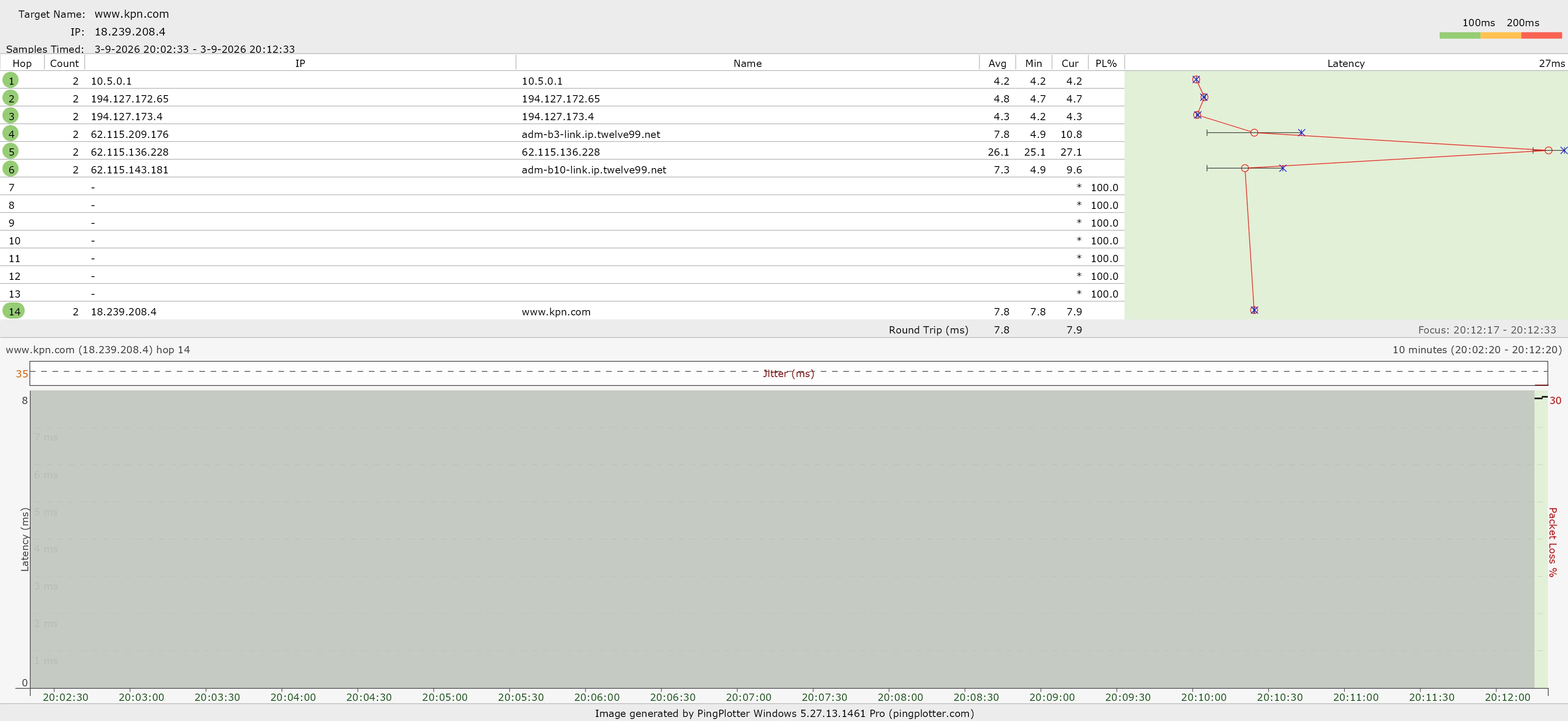

KPN:
         IP: 18.239.208.4
  Date/Time: 3-9-2026 20:02:20 - 3-9-2026 20:12:20
  1     2    0   4.24   4.24   4.24  10.5.0.1 [10.5.0.1]
  2     2    0   4.71   4.79   4.75  194.127.172.65 [194.127.172.65]
  3     2    0   4.24   4.34   4.29  194.127.173.4 [194.127.173.4]
  4     2    0   4.91  10.78   7.85  62.115.209.176 [62.115.209.176]
  5     2    0  25.14  27.07  26.10  62.115.136.228 [62.115.136.228]
  6     2    0   4.91   9.62   7.27  62.115.143.181 [62.115.143.181]
  7     2  100      *      *      *   [-]
  8     2  100      *      *      *   [-]
  9     2  100      *      *      *   [-]
 10     2  100      *      *      *   [-]
 11     2  100      *      *      *   [-]
 12     2  100      *      *      *   [-]
 13     2  100      *      *      *   [-]
 14     2    0   7.81   7.85   7.83  www.kpn.com [18.239.208.4]
