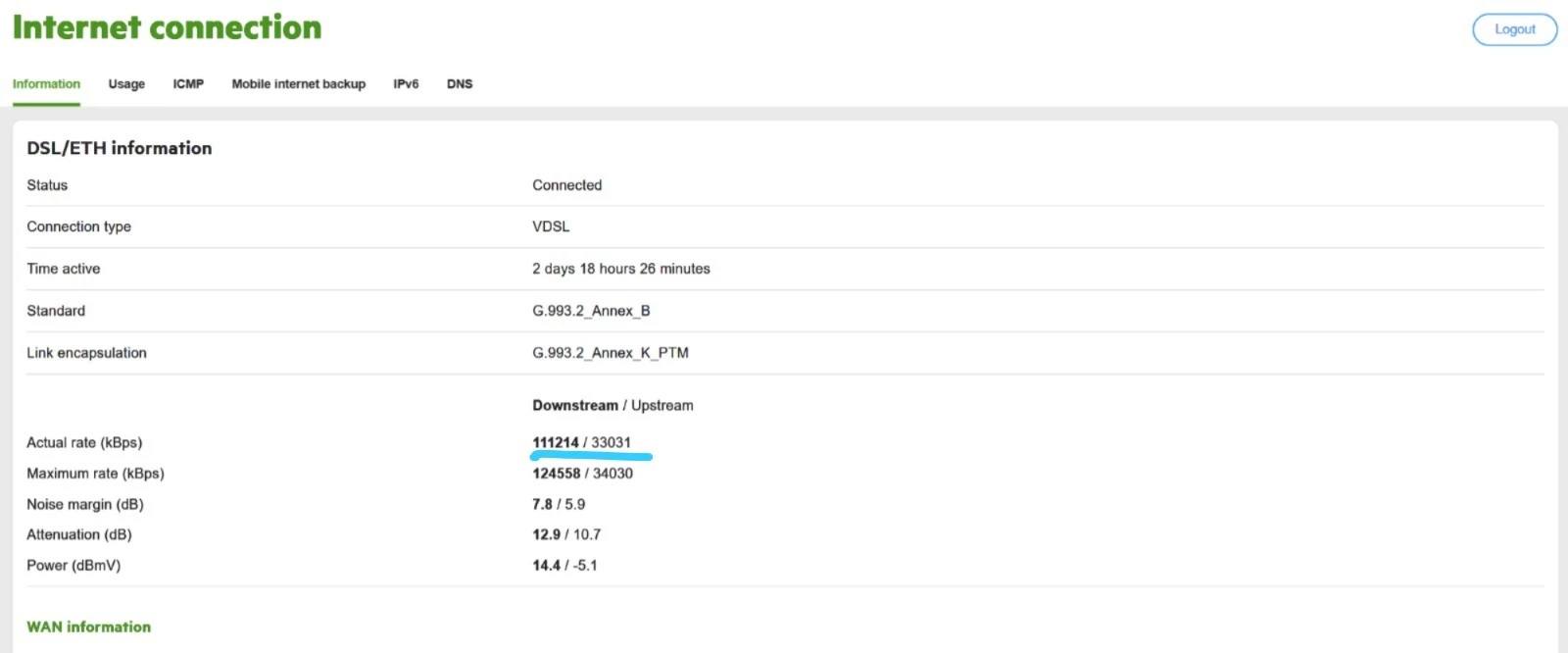

Hello,
I am on a 200 Mbps internet plan, but I noticed that my connection is capped at 111 Mbps (see actual rate in screenshot).
My current modem is KPN Box 12. I have a ISRA-2 point with blue and white sockets (dual bonding) but my KPN Box 12 doesn't seem to support this.
Do I need the Experia Box v10 instead, with a Y-cable to support dual bonding and reach the 200mbps I am paying for?
Thank you,
Eduard

  • mei 9, 2026 12:14 p.m. UTC
All modern ISRA’s are kitted out with 2 dsl ports. That doesn’t mean both should work. If you received a box12 and a single dsl cable then you have vdsl and not bonded vdsl.
rvk01
  • mei 9, 2026 12:16 p.m. UTC
But why would the subscription be 200Mbps then? Or is 200Mbps subscription the minimum now (even where the DSL line is max. 30Mbps)?
  • mei 9, 2026 12:20 p.m. UTC
No 100 is the minimum. But at his adres 124 is possible, and with a dsl / copper abonnement the speeds are not a minimum but a maximum. So with a 100 abonnement you’ll get 100 and with a 200 abonnement you can receive 124.
rvk01
  • mei 9, 2026 12:24 p.m. UTC
Clear. So it would be best for ​@eduard9 to see if there is a big price difference (there might not be, I’m not sure) and decide if those extra 24Mbps are worth that 😉

Thank you both for the swift reply.
The local dashboard in the screenshot I shared is showing max rate of 124 because there is only 1 cable plugged into the router.

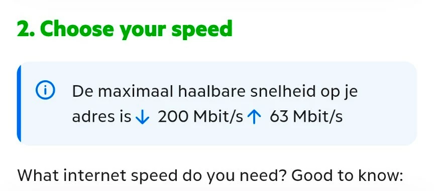

if I input my address at https://www.kpn.com/shop/pakket-zelf-samenstellen, it says that 200mbps is available here.
I also had some problems with the home delivery of my router, so I had to pick one up from a physical KPN store (the Box 12). This is what is still leading me to believe that my address supports bonded vdsl, and that I received/picked up the wrong router.
Is there a way to definitively check this?
Thank you

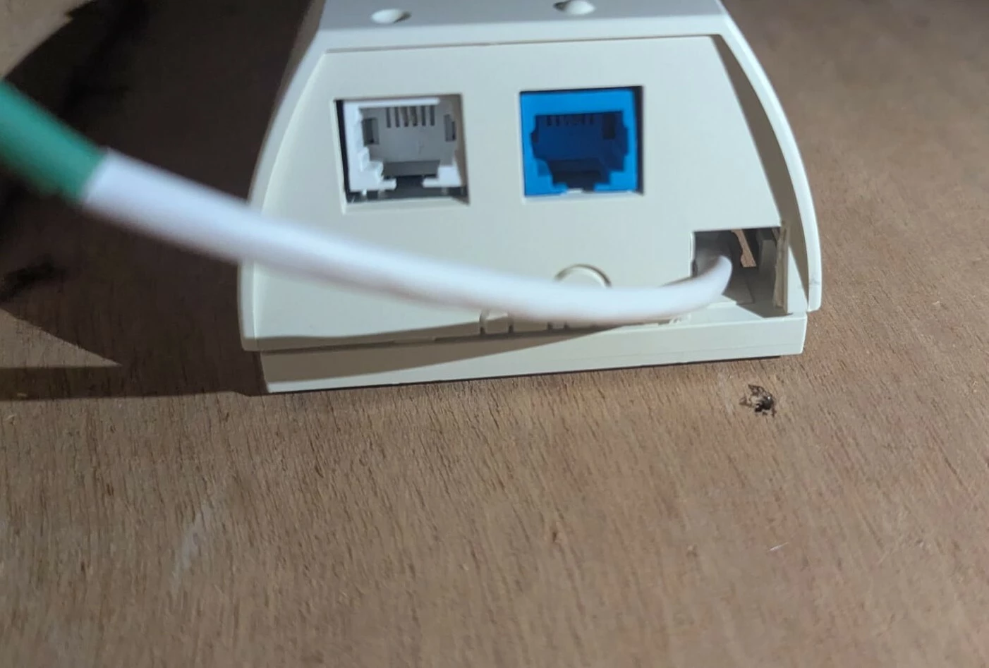

  • mei 9, 2026 1:06 p.m. UTC
You can try switching the cable from the blue port to the white port. If you have a working internet connection on both ports, you have pair bonding, meaning two pairs of wires connected to the local exchange. In this case, you’ll need the V10 modem.
  • mei 9, 2026 1:14 p.m. UTC
makes sense, will test this and report back

I switched the cable from the white port to the blue port in the ISRA-2 point, and I am getting no connection in the blue port. Light keeps blinking after waiting 10 mins.
If I'm right, this confirms that line 2 is not active and it's impossible to reach the 200mbps. Would it then be possible for a moderator to arrange for the 2nd port to be patched/activated by KPN, so I can reach the contracted speed?
Thanks
  • mei 9, 2026 5:56 p.m. UTC
​@eduard9 I think one of the lines isn't activated. You can open the plastic cover and measure the voltage between A and B with a multimeter. The voltage between A and B of a connected line should be approximately 50V DC.
  • mei 9, 2026 7:27 p.m. UTC
DSL has no voltage…
​@eduard9 you should contact KPN. 200mb is possible from your screenshot and if your modem isn’t getting it something is wrong. It might need to be fixed with an on-site technician.
  • mei 9, 2026 11:11 p.m. UTC
DSL has no voltage…
Without a modem, there is still a constant DC voltage between A and B. With a modem (active internet connection), you will typically measure an AC voltage because its value changes very rapidly

​@eduard9, can you give us a call? My colleagues can take a look at your line and subscription and send a technician if we need to. You can schedule a call on https://kpn.com/english
  • mei 13, 2026 7:30 p.m. UTC
A KPN technician resolved the issue today. Apparently there were 2 separate ISRA-2 points, and he plugged the y-cable into both points to get pair bonding. He also replaced the router with the Experia Box v10. I’m now reaching the full 200mbps speed.
