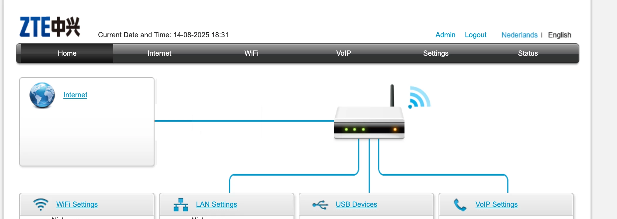

​@Erik van KPN  I’m back home now, it’s ExperiaBox 10 and this is what I see when I log in to the web interface.
This is the router info
Model H369A
Hardware Version V1.00
Software Version V1.01.00T04.4Intermediate

Thanks, Speedy! This is the older version of the firmware. I'm not aware of any existing issues with that firmware that could result in the problem you're having. Regardless, it seems that in the other topic, the problem was solved by migrating to the KPN Software. That Software is available for your modem type, so I would expect you to either already have it, or to get it shortly. Are you using any wifi extenders from us? SuperWifi or Experia Wifi?

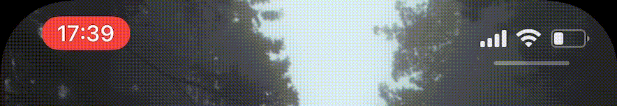

​@Erik van KPN I think my ExperiaBox firmware has been updated, the admin UI now looks completely different.
But my wifi now is a total disaster after the update… This is my phone the whole day today.

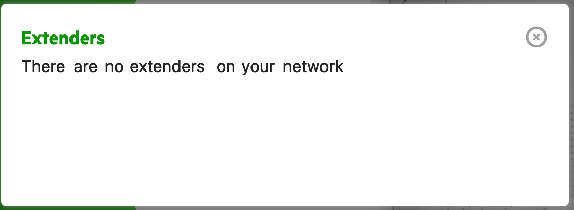

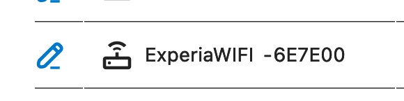

​@Maja van KPN I have the button and clicking on it shows this
As far as I understand the new UI only supports showing SmartWifi as extenders but not ExperiaWifi so ExperiaWifi will show up as a normal device and not as an extender.

Experia Wifi should show up here, when upgraded to the new KPN software ​@SpeedyGonzales. Could you please reset the Experia Wifi, when it's connected directly to the V10 with an ethernet cable? I hope that changes things!
​@Maja van KPN did a reset, still doesn’t show as an extender, only as a regular device on the network.
Ok, spoke too soon. Seems like it’s updated now and is showing up as an extender. But I can’t access it’s web UI (I assume that’s by design, but just want to double check)
