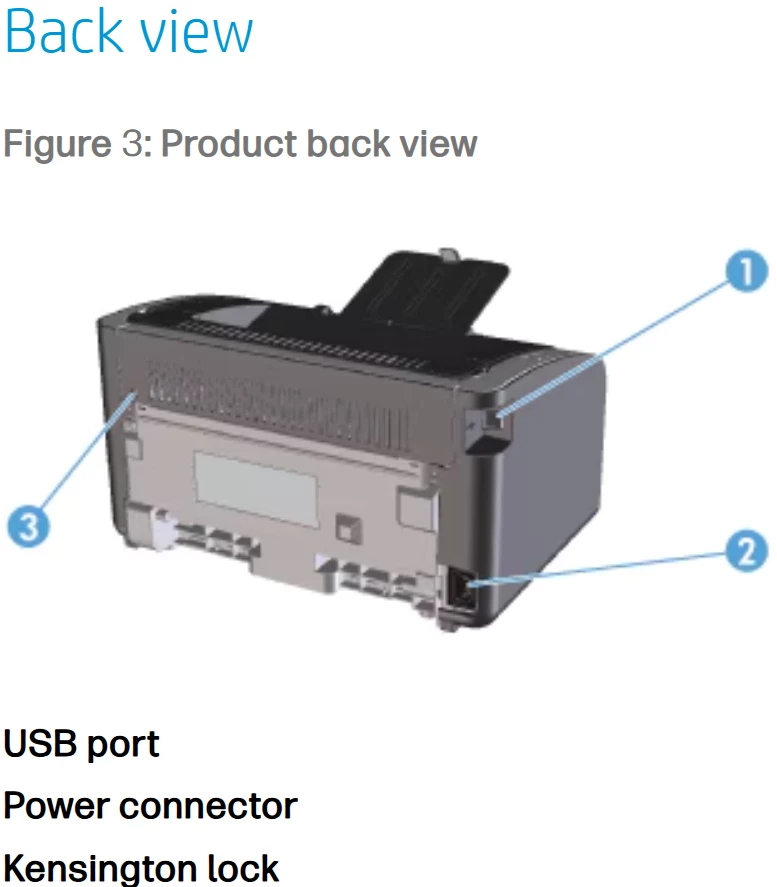

  • apr 1, 2025 3:32 p.m. UTC
1 - USB port
